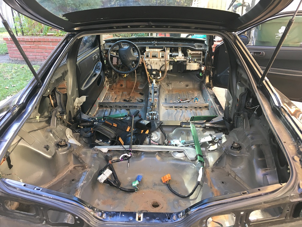

Ch 6. 01-0386 What did I buy?
Good News:
The car looks great coming off the truck and in the driveway.
Deeper Look:
Some Collision shop painted the whole car for $300, you can’t see the pearl through the orange peel.
Every molding in on the car looks like it was installed by my 3 y/o.
Front Window is not OEM or installed properly
Rear Interior panels both have major are cracks
Ashtray\lighter hang down since ears they clip into on the dash are broken off
Front bumper isn’t attached (I saw this from seller photos but didn’t realize it was because the upper radiator support was bend down to the so it couldn’t be)
Front left headlight leaks
Rear left taillight cracked open
Rack and pinon making a mess of the ground everywhere it’s moved
The Still Deeper Look:
No foam absorber and the front beam is barely hanging on the car
The front beam is barely hanging on the car because the threads in the frame ends are rusted out
The radiator support is damaged in several places and will need to be replaced
The floor pan of the car looks like it was driven as a rally car and front right corner is separated from the rest of the body
The spare tire well has quite a bit of rust and rear right seam is separated
The totally gutted (pun intended) confirmation:
Left front foot well has significant rust
Left side floor pan seam is rusted through nearly the entire length
Right side foot well has some rust and the carpet oddly is still wet underneath, probably from a leak when I washed it

Have made some progress with rust at least in left footwell, used to wire cup and abrasive wheel on my drill, sanded, and finally have pulled out the naval jelly. Was impressed with how well naval jelly has worked.
Also received a new old stock radiator core support I was able to locate.
