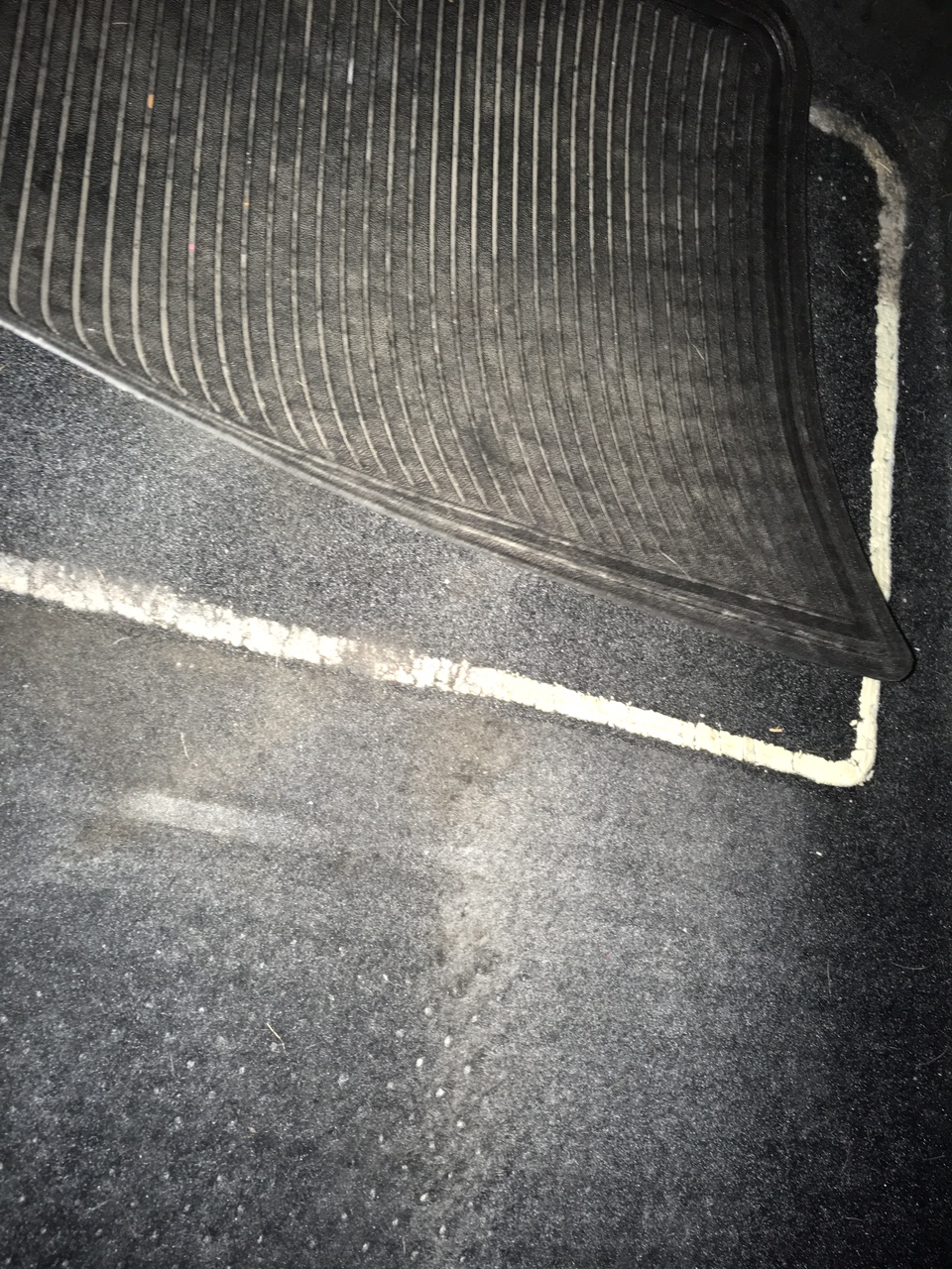

Did your carpet have the rubber mat on the driver side?

Stin1 wrote:Did your carpet have the rubber mat on the driver side?
It has some felt backing in places but I didn’t see any rubber. It was definitely original when I pulled it.

Post by Stin1 » Thu Oct 17, 2019 10:44 pm
Your before picture seems to have a rectangle on the driver side in white . Mine has the same imprint in white and I have this loose plastic mat thing that it seems was attached at the imprint. I don't know if it's supposed to be there so I haven't removed it . If it's supposed to be there I got to find some adhesive for it.

Post by Stin1 » Thu Oct 17, 2019 11:11 pm
It's on the exterior. This is mine. The white is felt. Never noticed that.

Post by aklackner » Fri Oct 18, 2019 11:03 am
Oh, yeah there was a line of hard white on the carpet, it was almost like plastic or old dried wax. I suspected an aftermarket foot support had been glued down, guess it was less aftermarket. I'm happier to have the white crud gone now, removal wasn't fun. Under floor mats (Non-R checkered came in the shell, A set of new EU R mats, or a set of cut to fit Weathertech mats will always be in) I don't see any need for additional protection of a wear guard.
