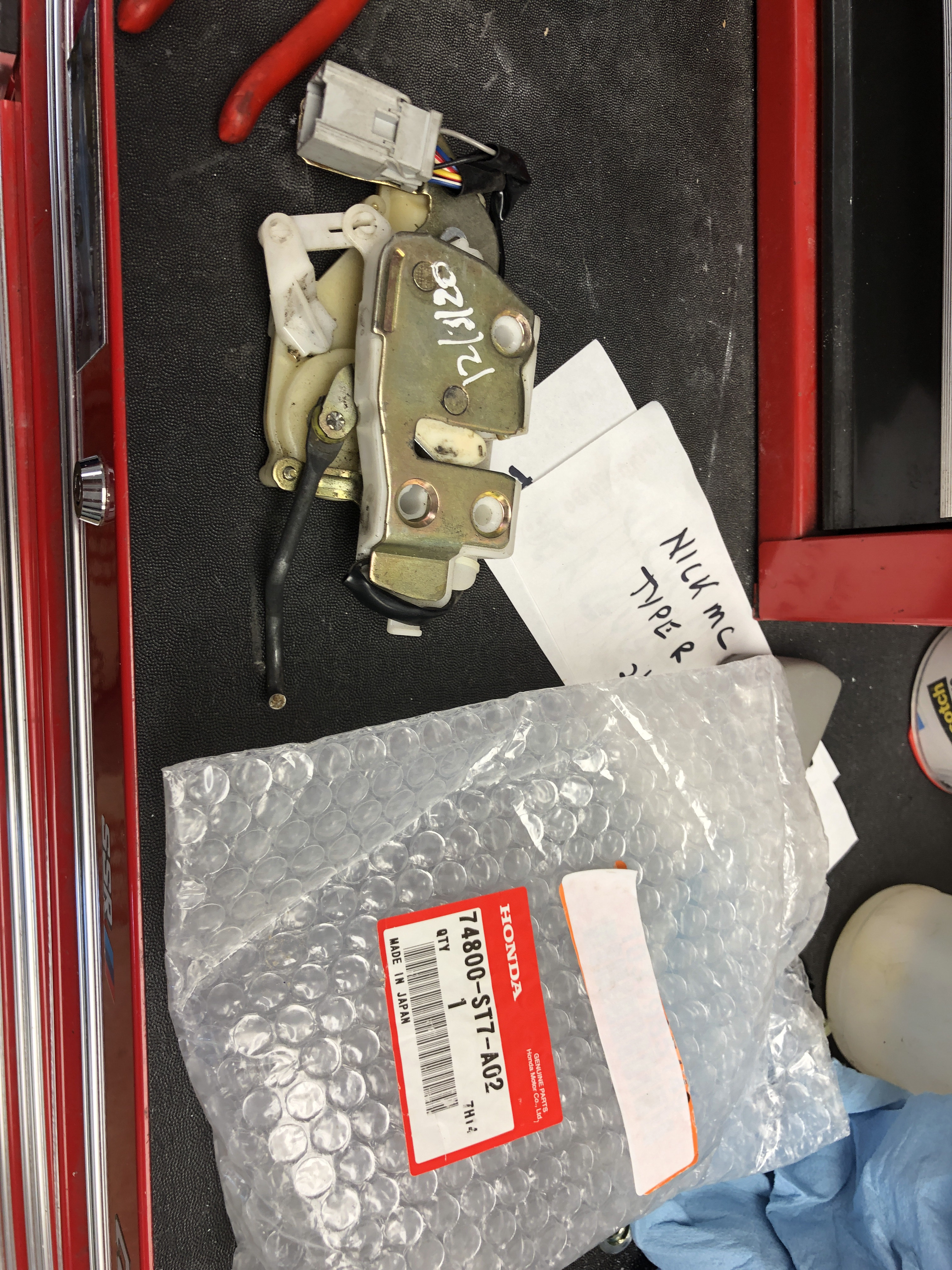

Make sure you have good power and ground to the relay. I was having issues with my hatch after I had put everything together. The circuit is a little convoluted. My problem ended up being the latch itself. I went through 3 used ones before I bit the bullet and bought a new one from Acura.

Mine was electrical in nature. They all worked mechanically. In the wiring diagram you’ll see “hatch latch switch”. It tells the car weather the hatch is locked or not. There is no physical contact with any linkage. It’s simply a micro switch attached to a small servo in the latch itself. If you look at my pic of the latch it’s the small plastic white linkage below the plug. The relay will not be energized if this is open. If the servo motor is bad the only way to be sure is to physically move the switch by hand, turning the key won’t move it. You can also jump the terminals to verify it’s not the micro switch.
