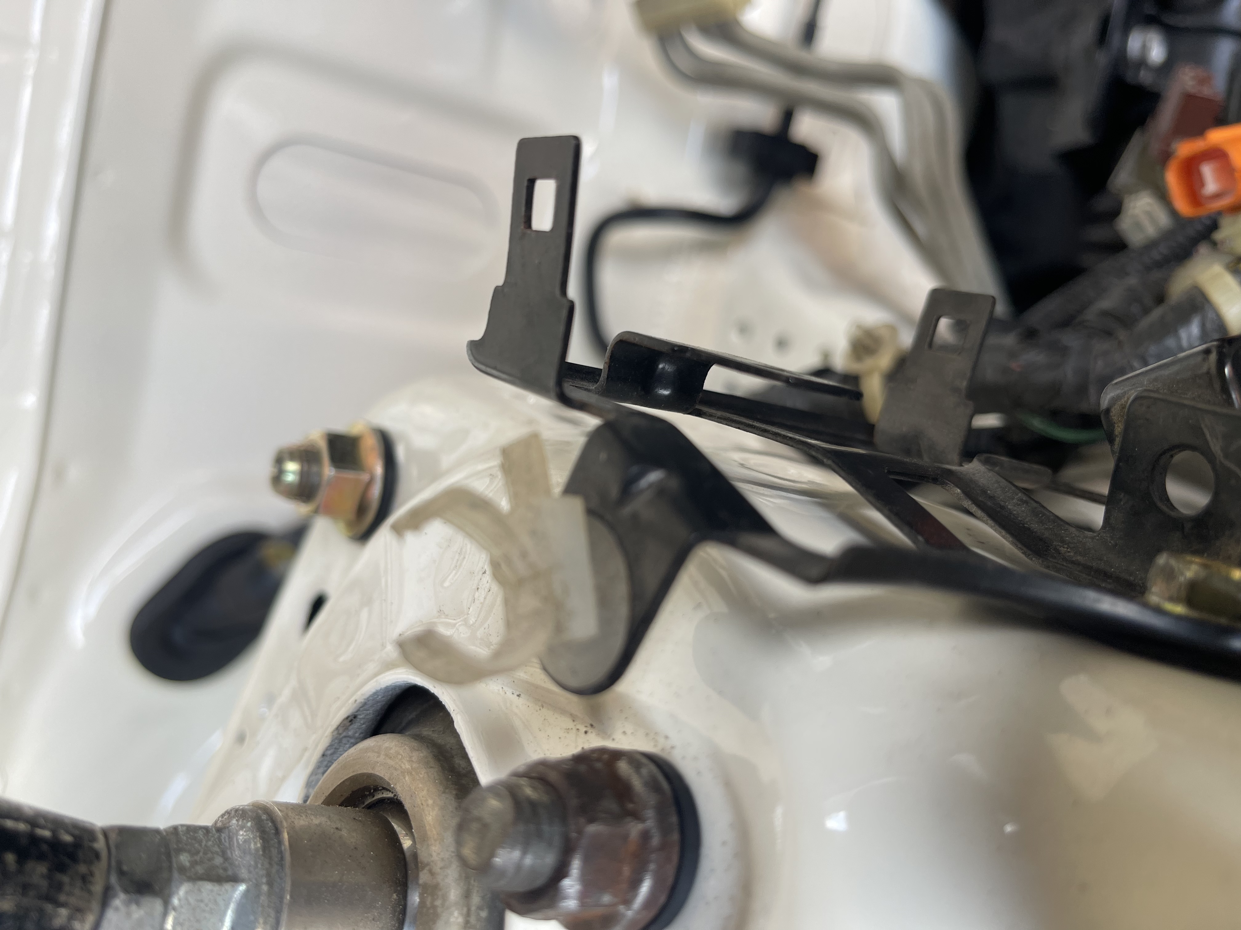

Hi, I’m currently putting my caR back together and have a few questions. I figured I’d make a thread here and update it as I go in hopes it could potentially be useful for others.
Evap question + harness clips
I’ve noticed that my canister has a provision for a hose on the back. However, I do not have a hose that would go attached there. Can anyone confirm if there actually is a hose that goes here, maybe from the intake?
Secondly, I’m sure anyone doing a Honda restoration has come across this problem; harness clips. Does anyone happen to know where we can find them, Honda has long discontinued them. I do remember seeing someone list them on a fb page but they were gatekeeping the vendor. Oem grade would be ideal but something similar would work too!

Vtecwreck wrote: Sun Aug 06, 2023 2:19 pm I’ve noticed that my canister has a provision for a hose on the back. However, I do not have a hose that would go attached there. Can anyone confirm if there actually is a hose that goes here, maybe from the intake?
As far as I know, my '98 USDM EVAP system is untouched, and it has the same unused hose provision. I can't solve any mysteries as to what it's for, but I don't think it's used.

Vtecwreck wrote: Sun Aug 06, 2023 2:19 pm ure anyone doing a Honda restoration has come across this problem; harness clips. Does anyone happen to know where we can find them, Honda has long discontinued them. I do remember seeing someone list them on a fb page but they were gatekeeping the vendor. Oem grade would be ideal but something similar would work too!
91558-ST5-003 for both USDM and JDM - You'll find those pieces in the "Engine Wiring Harness" section as @navin pointed out. You can find aftermarket replacements on eBay (can't vouch for these though)

navin wrote: Mon Aug 07, 2023 10:24 am The clips aren't discontinued. .
https://www.acuraautomotiveparts.org/v- ... ss-clamp-2
You’re right, thanks!
Thank you! The aftermarket clips are not to my liking. I do have a few spare harnesses that I may take the clips from if I can find any that are not discolored. Otherwise I’ll put an order in.
