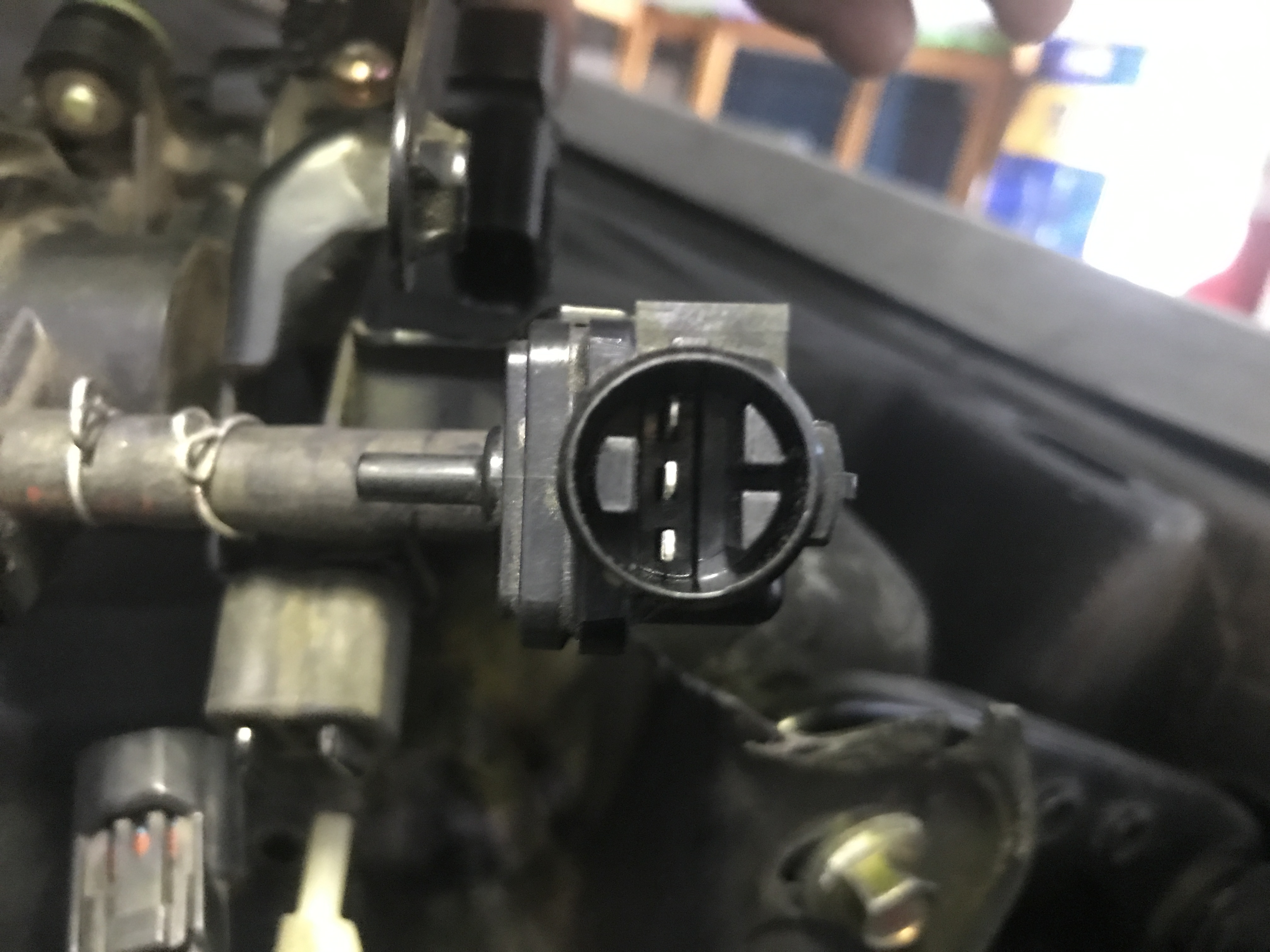

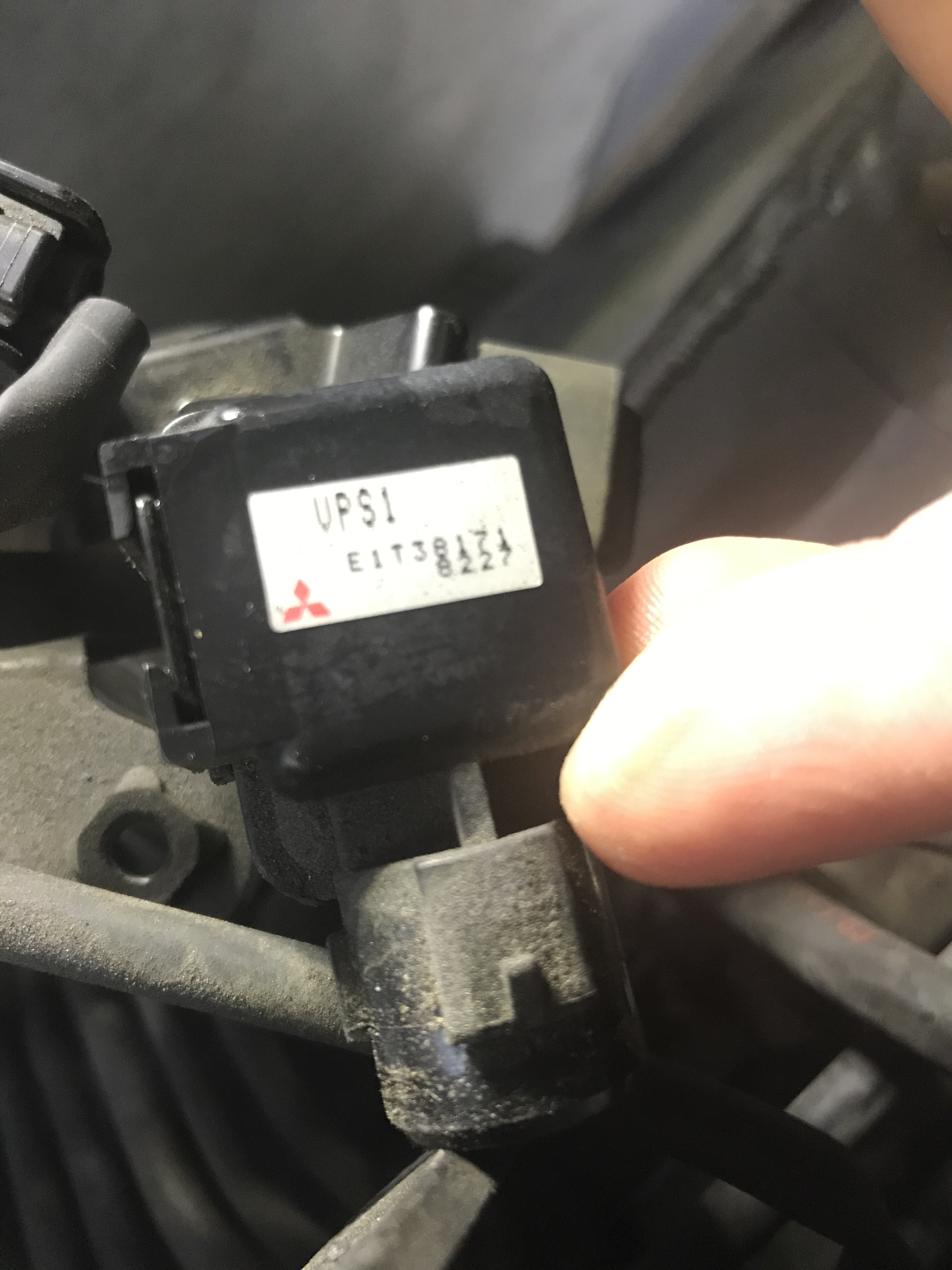

Just pulled my 98 sensor off this morning
The round connector looks identical to the 00/01 NGK replacement 🤷🏻‍♂️🤷🏻‍♂️🤷🏻‍♂️
Not brave enough to spend $250 to find out if it works. So gonna hit pick and pull first since the 98 type r one are shared amongst all 98/99 integra.
