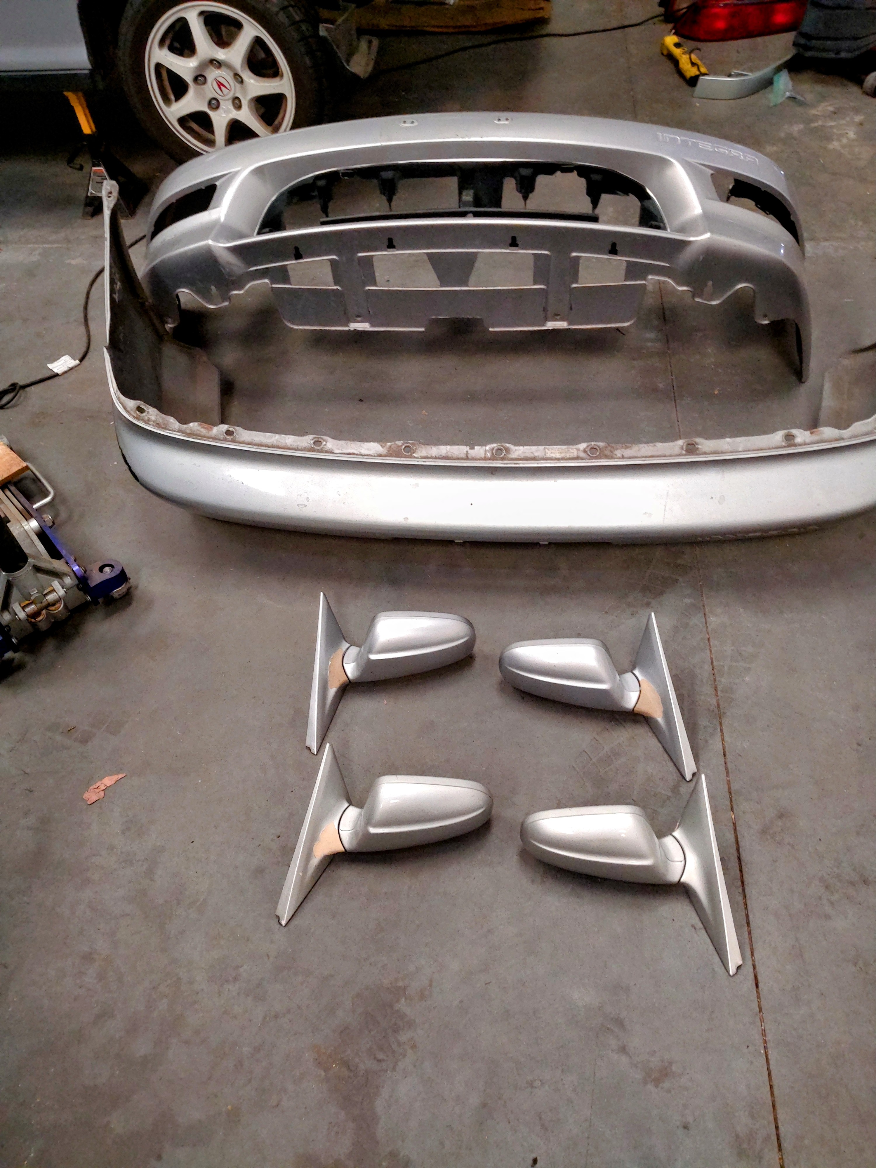

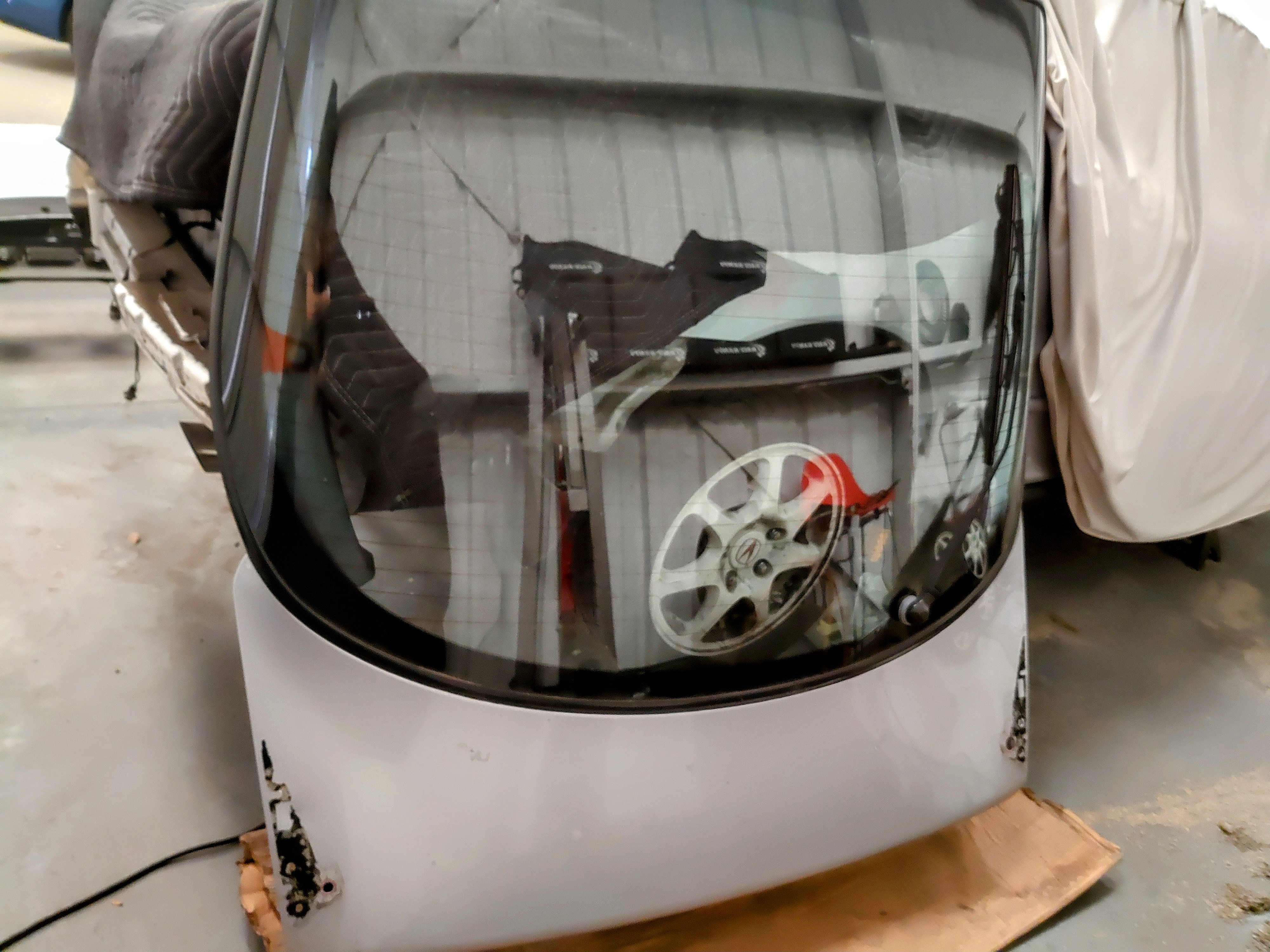

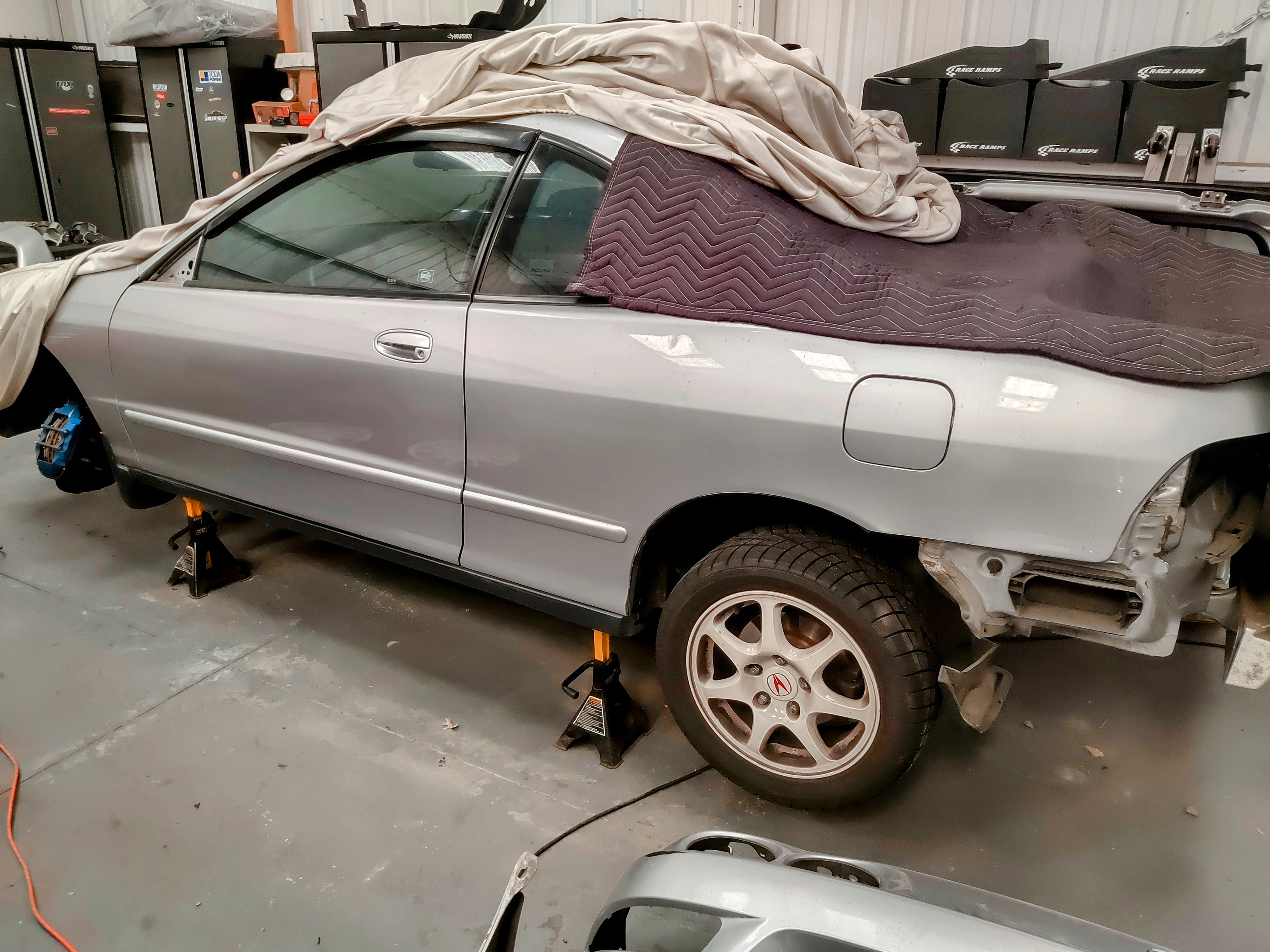

Thanks of JDMJNKY, I might have found someone to paint some body parts. I took off the bumpers, mirrors, and trunk lid.
The rear bumper is kind of a process to take off. Same with the trunk lid lol.

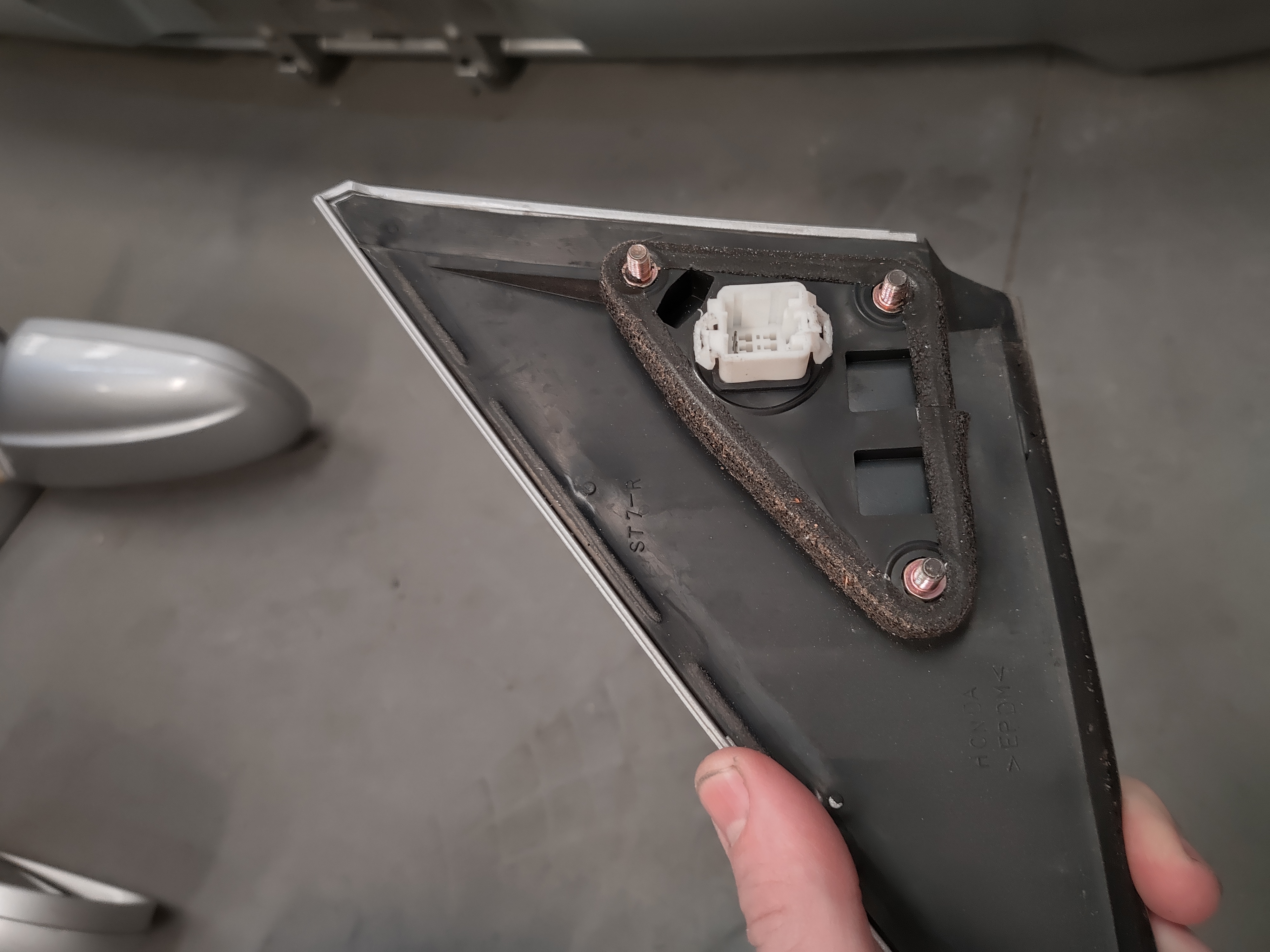

I'm getting two set of mirrors painted, because one set is supposed to be a JDM power folding version. Although comparing them they have the exact same part #'s as my GS-R oem mirrors. But maybe the JDM's are slightly heavier and have the motors inside? I wrote "M" on the one that's supposed to be motorized. I'm hoping they are legit. I have the rest of the wiring pieces for them, which hopefully I'll be able to install.

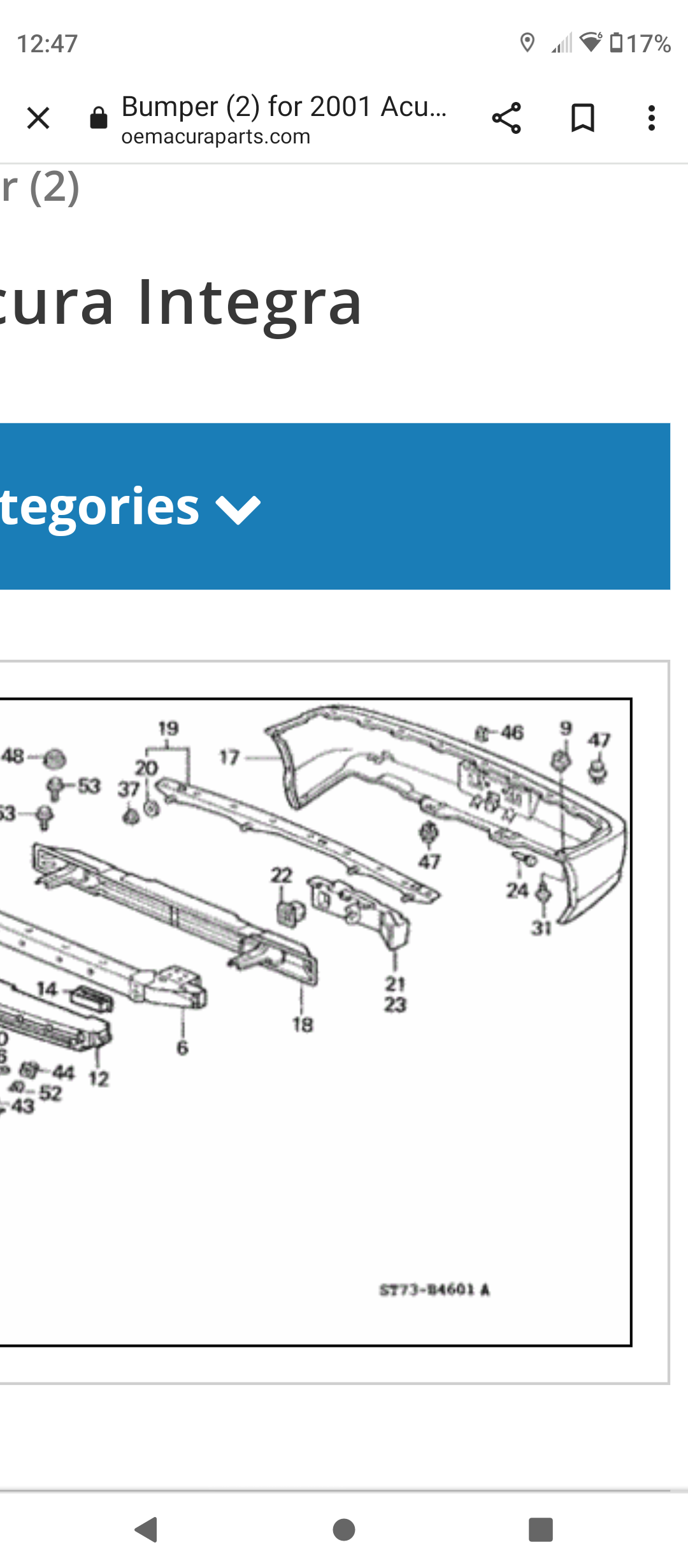

Here's a tip that will help you out with that rear bumper. You should have pulled the bumper off slightly different so before you reinstall it take that thin black support bar off (above the bumper support beam)and reattach it to the bumper. You will need to pull the rear interior panel to have access to the hardwares but it's a much easier approach to removal and installation of the rear bumper.

Yeah I should have noticed that in the pic because the rear filler panel has been removed.
With that out of the way you can remove the 4 nuts(#37) holding the rear upper bumper support beam(#19) to easily remove or install the bumper without the need to remove the filler panel to get access to the clips.
#19 is what causes the notoriously known rear bumper sag.
Aha, I think I understand. Good to know. :thumbup: Wish me luck when I reinstall the bumper and decklid.
