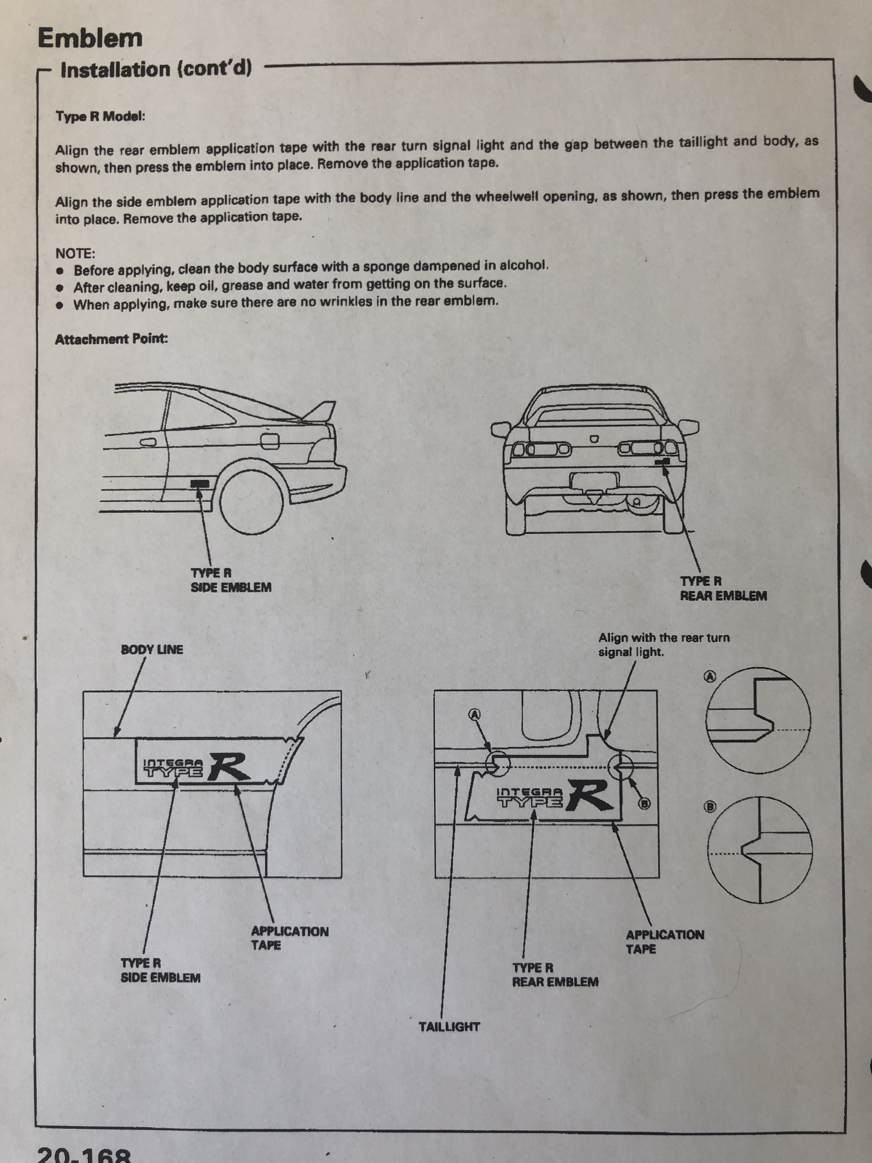

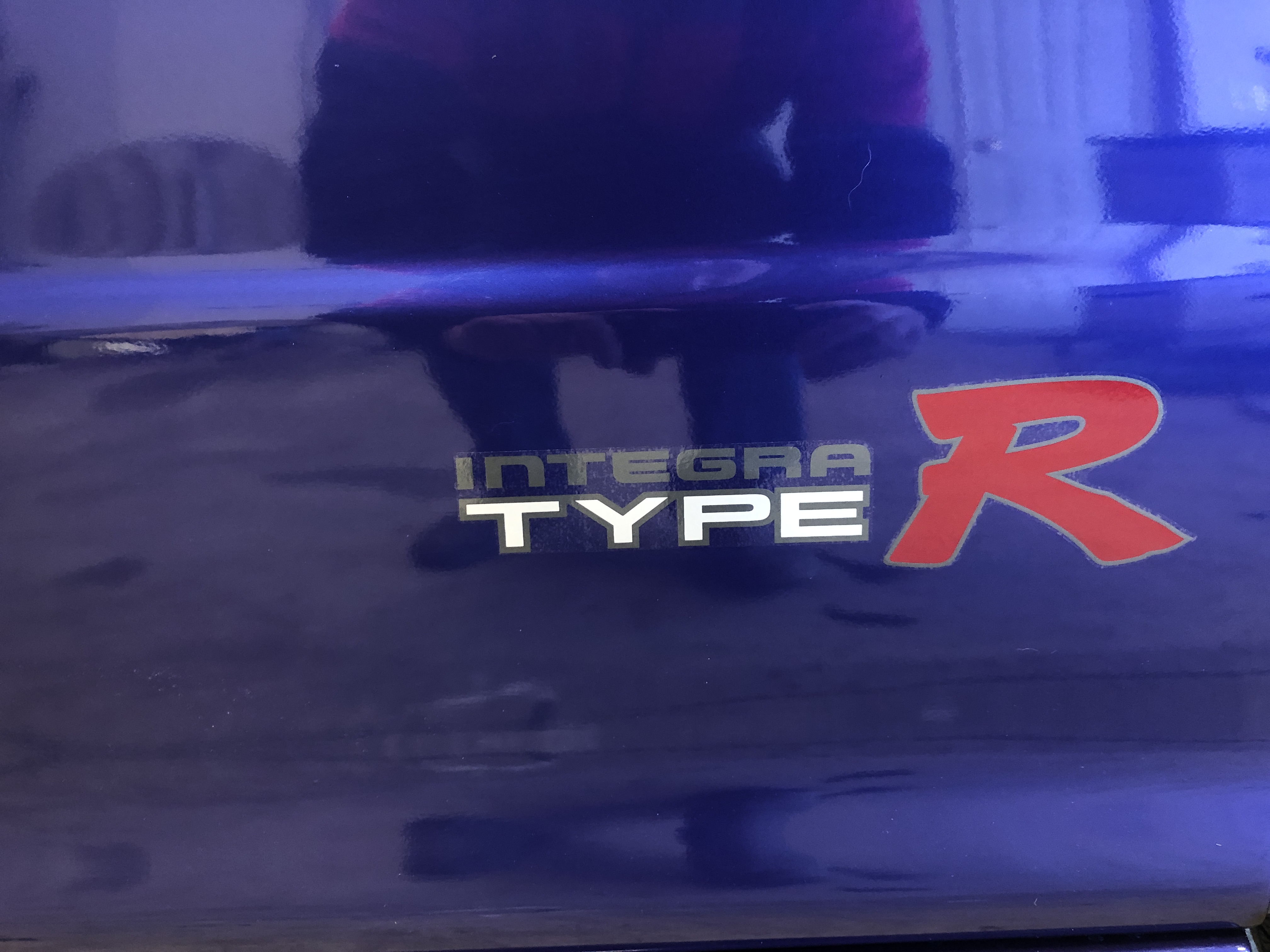

First weekend off in over a month so I was able to get out in the garage again. I wanted to wait at least 90 days or so just to make sure the paint cured before I put these on. Unfortunately, I ended up with the wrong emblem for the driver side and had to order another one. I used the type 4 stickers for the darker color contrast. Type 3 being for PY / CW and type 4 for the black cars. Went I was looking these up I notice quite a few PY/CW cars with the wrong stickers but honestly the can pull off using the wrong one and not be noticed. Using the type 3 sticker on the SSBP color it was difficult to see at a distance. When ordering these the part numbers are the same except the last letter. “ZA” for type 3 and “Z
B”for type 4, or you can say “B” is for black cars if you want an easy way to remember.
