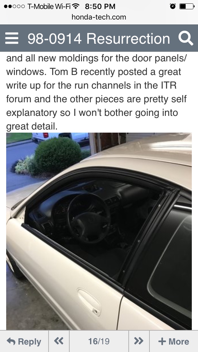

Stin1 wrote:Not the sash covers . The sash tape for the subseal.
Numbers 5&8 . I believe it goes between the subseal and the door. There wasn't any on the one that was originally removed. Unless the sash just got discontinued, I think you are good on those. Sorry about confusion. Spoonfed asked if I got the sash and got confused with the sash tape too . Lol
I’ll try to clarify lol. The sub seal has no tape, it’s simply hooks into the door frame channel at the top. The subseal seats the roofline to the runchannel. The tape you’re referring to is sash tape and corresponds to the sash guide track (see diagram below #6,16), not the sub seal. The tape in your diagram doesn’t hold anything onto the door itself. It’s so you don’t see a bunch of white around all your black trim surrounding the window glass area.
I got you. I think you are right on the seal not being in the right place. I messed with it. At this point it's worse. I will keep on messing with it. The corner isn't seated properly.However, the tape I am talking about I believe is different than the one you are referring to . I think number 9 goes to the parts you are referring to. The one I thought was for the subseal , I found built to grind has some pics on ht.
It also looks like his corner has the same wonky appearance mine has before it pulls away.
