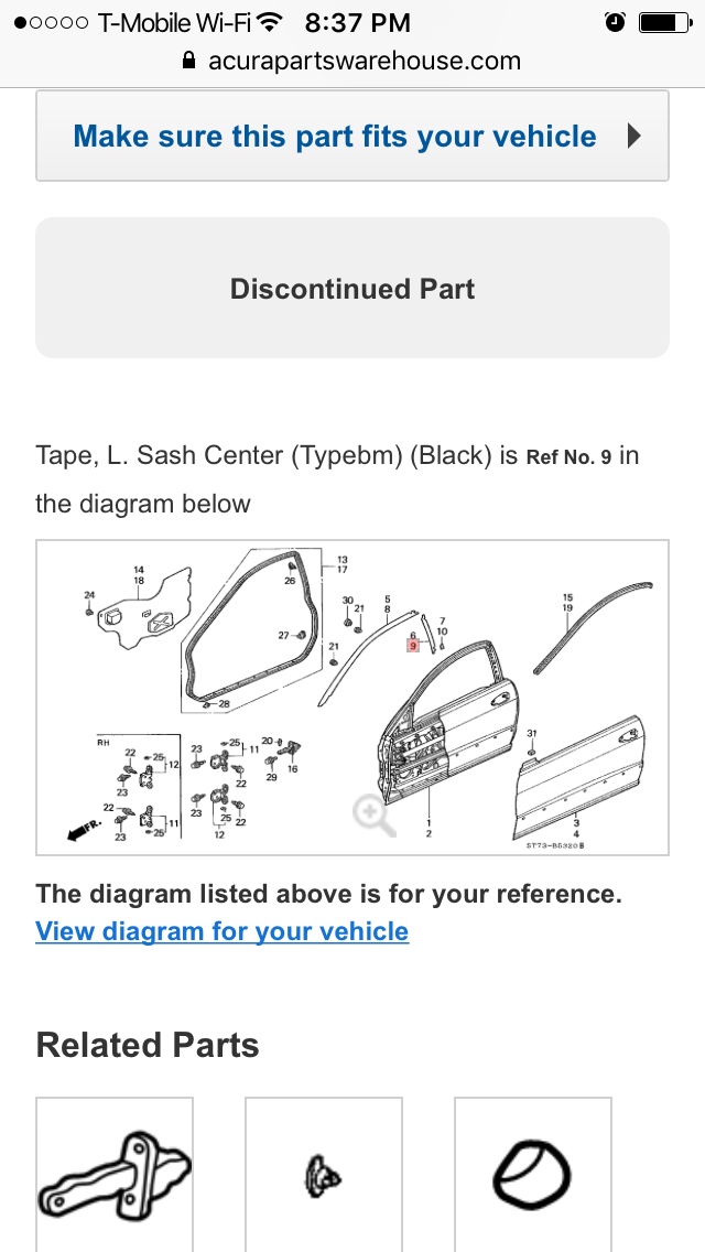

Did you get the sash tape for the subseal? I saw it's now discontinued. Also do you think I can pull mine off and reinstall with the door panel and mirror on , or will I need to remove them ? I have an issue with the new quarter glass pulling the subseal off the run channel and top of the door when opening and closing the door .I have the tape . I am a little weary about the install because I don't have the most steady hand when applying decals and if I mess that tape up I won't be able to replace it.

I have the old sash covers from the ITR and from the LS all in good condition. It looks just like a double sided tape on the back that holds it on. I also ordered new but if they are now discontinued who knows if I’ll receive.
All the seals installed pretty easily with everything apart. Hard to say what would get in the way but I think you’d need to get the upper run channel down to get the subseal in well.

Stin1 wrote:Did you get the sash tape for the subseal? I saw it's now discontinued. Also do you think I can pull mine off and reinstall with the door panel and mirror on , or will I need to remove them ? I have an issue with the new quarter glass pulling the subseal off the run channel and top of the door when opening and closing the door .I have the tape . I am a little weary about the install because I don't have the most steady hand when applying decals and if I mess that tape up I won't be able to replace it.
I don’t think the tape you’re referring to will solve the issue. As far as I can tell the tape is more of a protective film and blends the black seals visually. That upper long sub seal doesn’t require tape to install nor the runchannel itself. Did this didn’t occur prior to your rear quarter glass install? Could that trim be slightly out of alignment and catching the seal?

Not the sash covers . The sash tape for the subseal.
Numbers 5&8 . I believe it goes between the subseal and the door. There wasn't any on the one that was originally removed. Unless the sash just got discontinued, I think you are good on those. Sorry about confusion. Spoonfed asked if I got the sash and got confused with the sash tape too . Lol
It had no problem with it on the original subseal . When they pulled the quarter panel glass , I had no problems as well. The gap seems pretty similar to the other side maybe a little tighter. If I pull on the subseal where it's attached to the run channel the snaps pull easily from each other and expose the top of the door. The passenger side doesn't have the same looseness at that corner if that makes any sense. I haven't pulled the back of the tape yet but the big one looks white not black . The mystery 9 one is black . Definitely open for advice.
