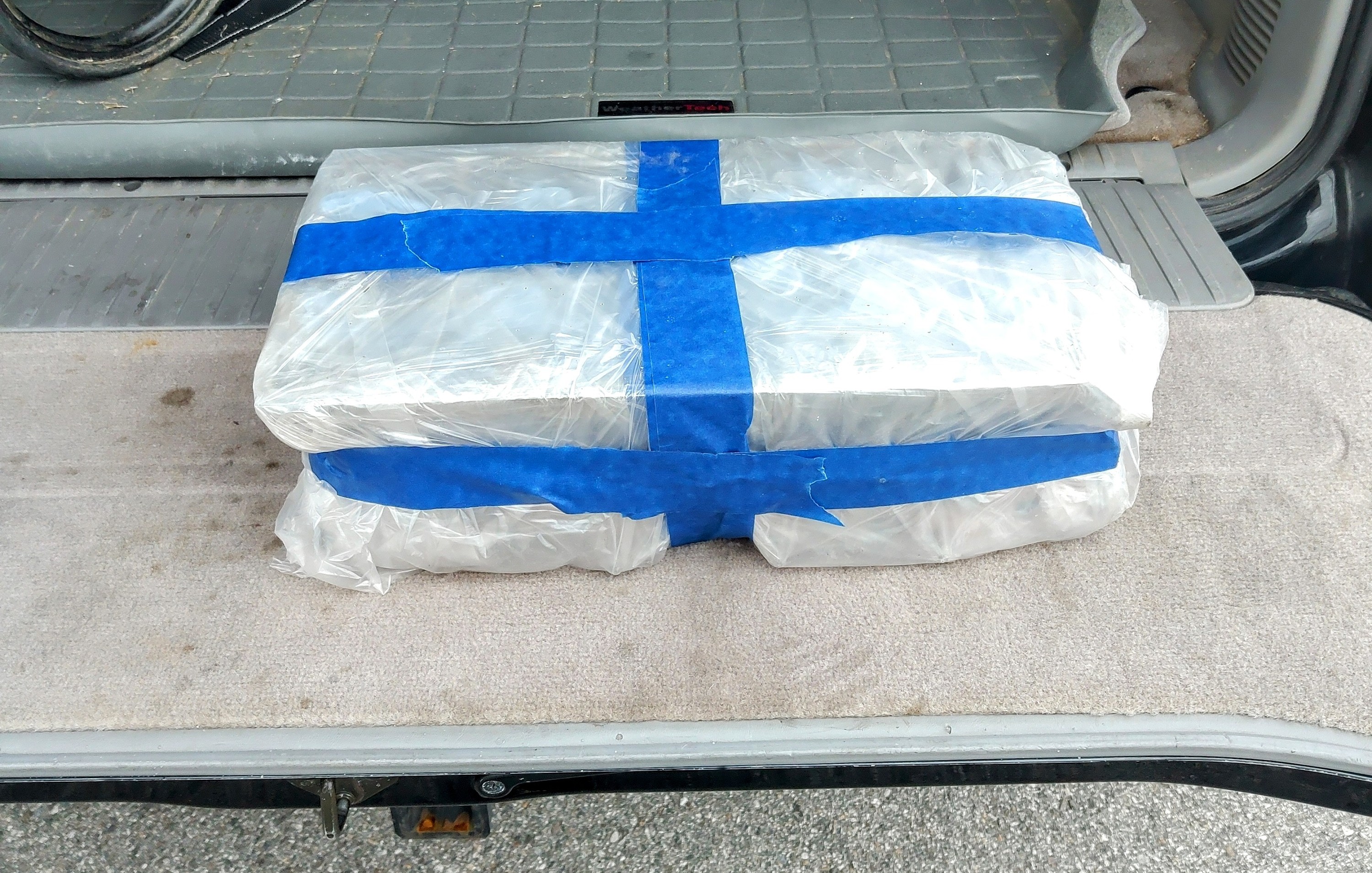

I placed an order with 4 Pistons today and shipped out the cylinder head! Intake and exhaust ports will be ported, valve job, resurfacing, hot tank and soda blast. I also decided to go with bronze valve guides. I talked to the guy (Luke?) and he said they last a long time. Since this isn't a daily driver necessarily, I figure it will be fine. New valve guides seem like a good idea for less valve stem movement.
I am pretty sure I am going to go with full ferrea valvetrain. That sounds so awesome to me. I'll install myself once the head gets back, apparently lead time is around 5-6 weeks. I'm pretty excited, and stoked about how much I've already learned in this process.
- IMG_20230321_150743924~2.jpg (1.53 MiB) Viewed 3460 times
You will not be disappointedDave7CDMTYPER wrote: Tue Mar 21, 2023 7:46 pm I placed an order with 4 Pistons today and shipped out the cylinder head! Intake and exhaust ports will be ported, valve job, resurfacing, hot tank and soda blast. I also decided to go with bronze valve guides. I talked to the guy (Luke?) and he said they last a long time. Since this isn't a daily driver necessarily, I figure it will be fine. New valve guides seem like a good idea for less valve stem movement.
That's good to know he vouches for them lasting long term. He would know more than me so I'm glad you spoke with him.
If you're anything like me it will be hard to stop drooling over the CNC port work and the beautiful machine work on the deck when you get the head back.
