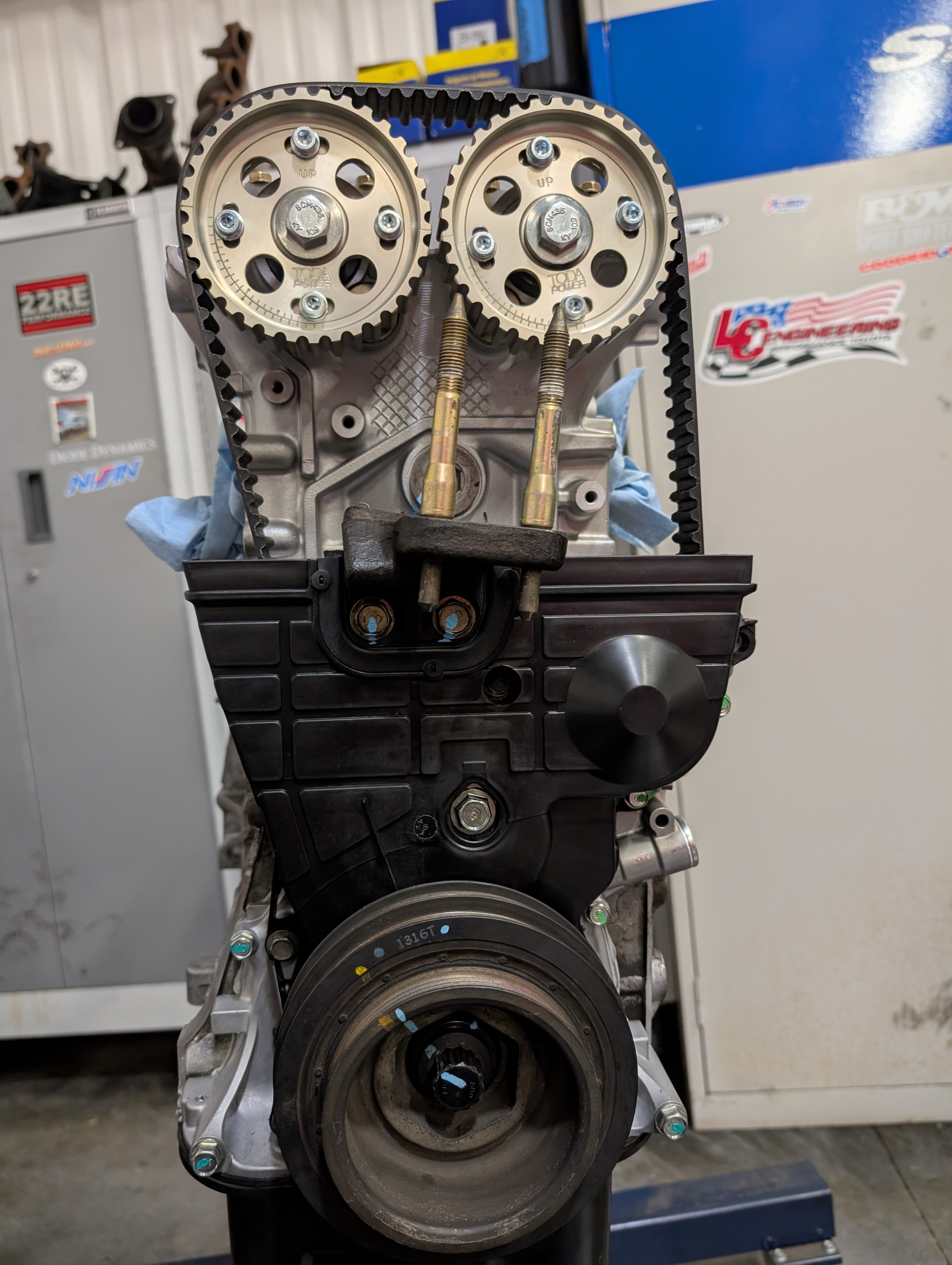

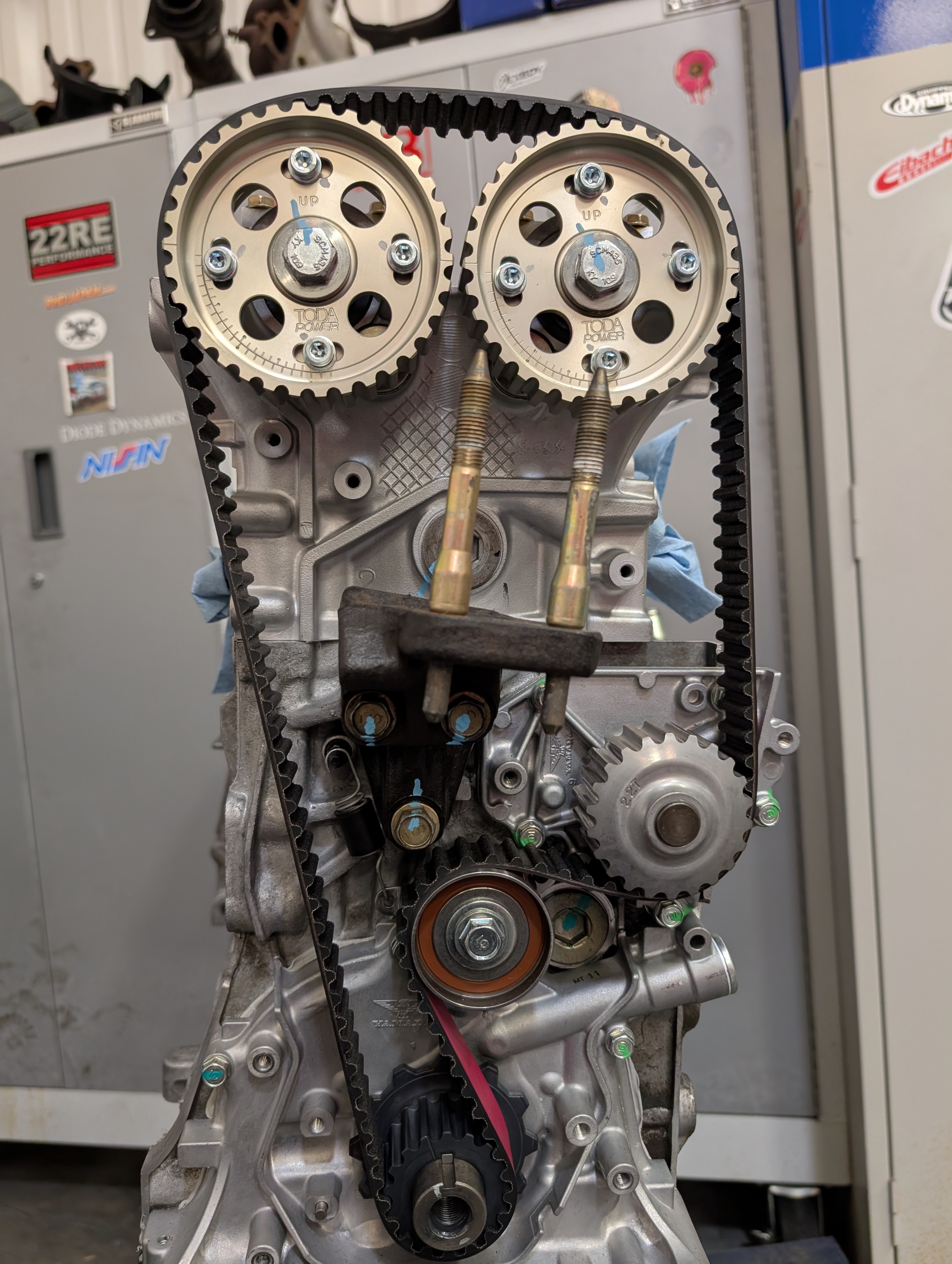

I'm working on the timing now. Was able to torque the crank pulley bolt. I'm a little uncertain about some things. The cam gears are generally at TDC, but they aren't both at exactly the same orientation in terms of the their markings. The intake gear is a little to the left. But these positions seem to be how they want to sit (when I was adjusting them without belt on).
I tested the timing by rotating the crank pulley counter clockwise several times. It seems to rotate smoothly with no evident interference. Does that mean it's ok?
Also I'm trying to add tension with the tensioner. I followed the FSM instructions, but it didn't seem to make any difference in the tension.
I'm wondering if these things are all generally fine. And when I take the car to a dyno shop, will they be able to adjust the timing if needed? I know cam gears are adjustable. But as far as I can tell it wouldn't be too hard to adjust the timing belt when the engine is in the bay.

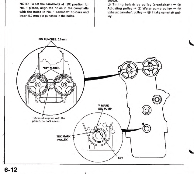

Can I suggest looking at page 6-12 of the 98 service manual. Although it is in the B18B1 section, It shows using pin punches to lock the cams at TDC using holes through the camshaft holder/overhead oil galley plates . I know the factory cams have holes to allow punches to lock the position. Looking at TODA's page, I don't see holes in their cams so this may not work. I haven't used the punches method myself as I do the marking transfer method, but noticed they are there as a possible assembly aide.

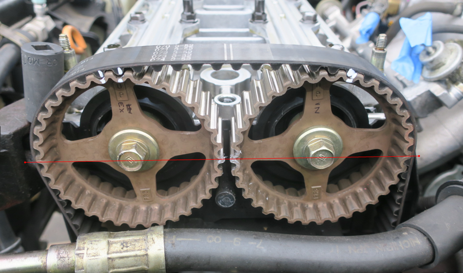

Alternately, there are marks on both sides of the cams at 3 and 9 o-clock so you can run a straight edge between the two cams to level the hash marks out in a line. That is probably what the designer intended. Here is what my alignment looked like on my car

Thanks very much for posting. I did learn recently about using the punches, and I do have 2 5mm. I don't think the Toda have the holes for this method (would be nice), but I'm going to go back to my shop today to work on the timing. I am aware my timing is not correct and will definitely be figuring this out until it is correctly done.shuttlepilot wrote: Mon Feb 10, 2025 9:53 pm Can I suggest looking at page 6-12 of the 98 service manual. Although it is in the B18B1 section, It shows using pin punches to lock the cams at TDC using holes through the camshaft holder/overhead oil galley plates . I know the factory cams have holes to allow punches to lock the position. Looking at TODA's page, I don't see holes in their cams so this may not work. I haven't used the punches method myself as I do the marking transfer method, but noticed they are there as a possible assembly aide.
Thanks for posting that photo, it does help and I understand that the cam gears need to be lined up with the horizontal lines at 9 and 3 o'clock. I see how you did your timing belt with the lines in the top middle and marked the belt with white marks. I'll do that too.

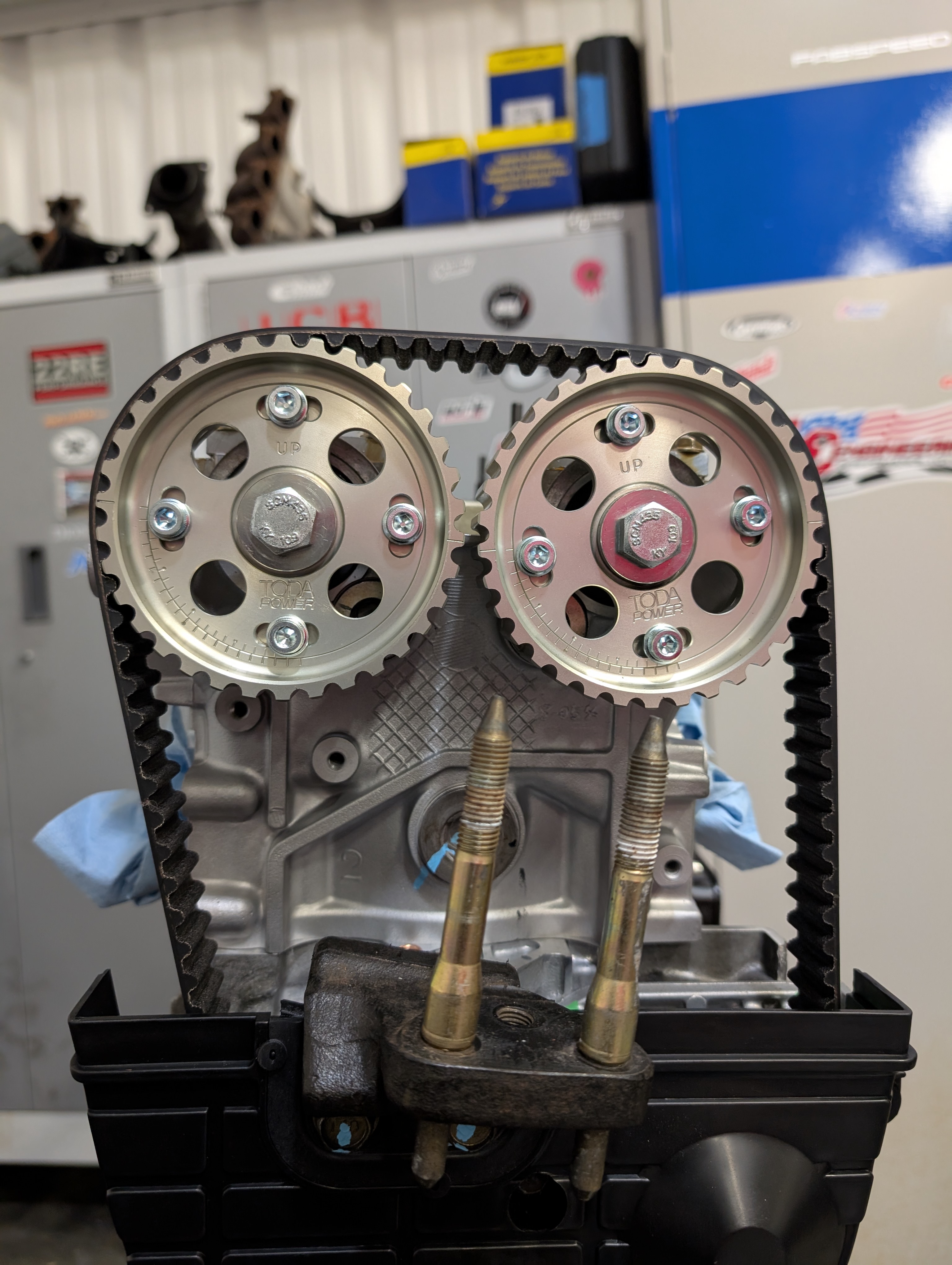

Alright, I think I'm getting on the right track here. Today I torqued the cam bolts to OEM spec, and torqued the Allen wrench Toda bolts to 10 ft lbs, which is within the Toda spec.
I got the cam gears to be pretty much level, looking at the horizontal lines, to be lined up horizontally with the block and each other. And the timing marker on the crank gear is lined up with the oil pump marker.
The timing belt seems a little loose in between the cam gears. But maybe that is normal, and will adjust properly when I tension the belt? I got the belt about as good as I can. I'll torque the crank bolt back on maybe tmrw and and see how things are. Really excited to keep moving forward and do the valve adjustment etc.

Thanks in large part to DC2 Productions text support, I got the timing belt tensioned correctly today. The timing marks look good. Got the timing covers on. Next up, valve adjustment!
Learning how to do the timing belt correctly was a process, but now I understand it much better.
