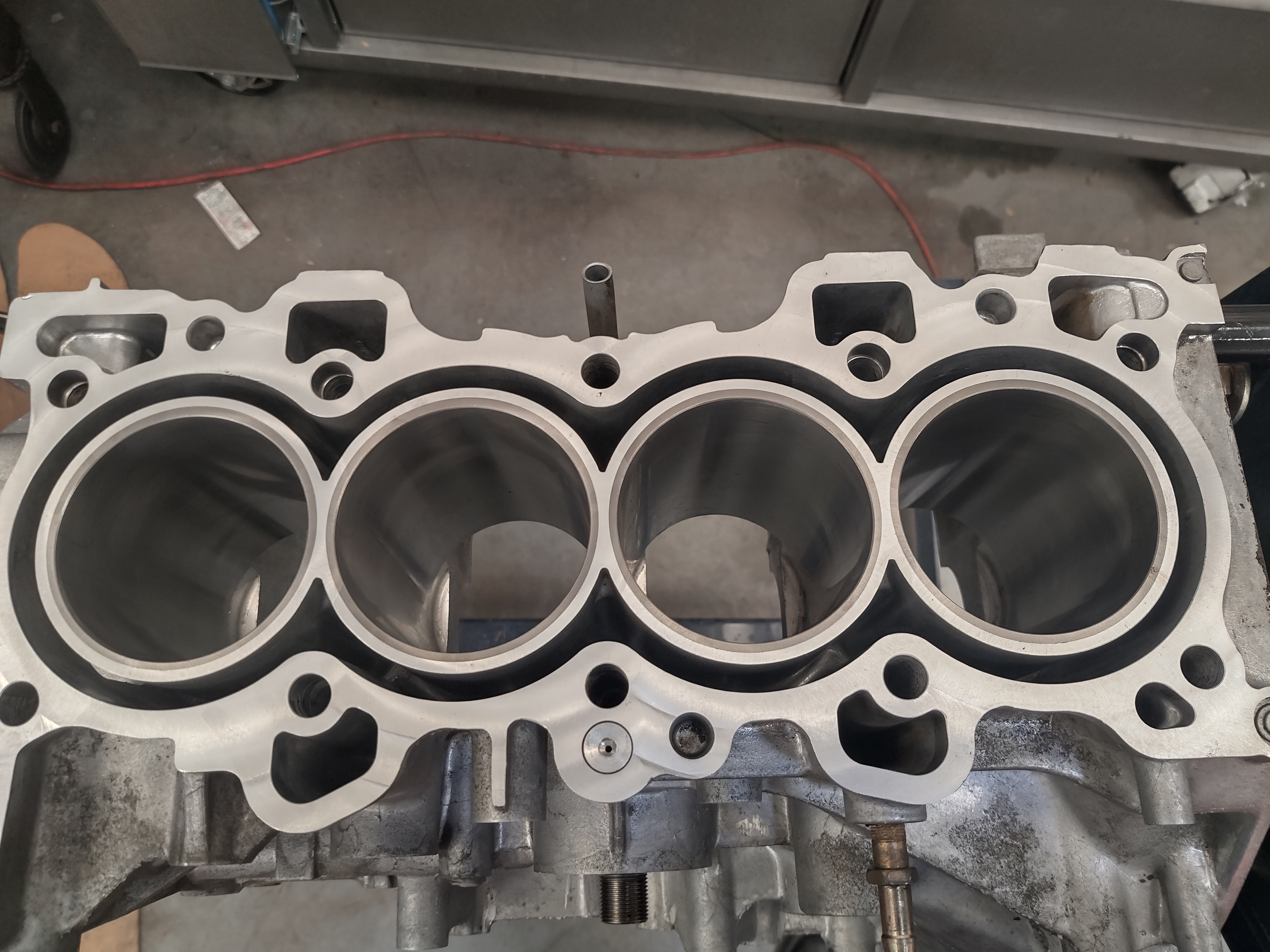

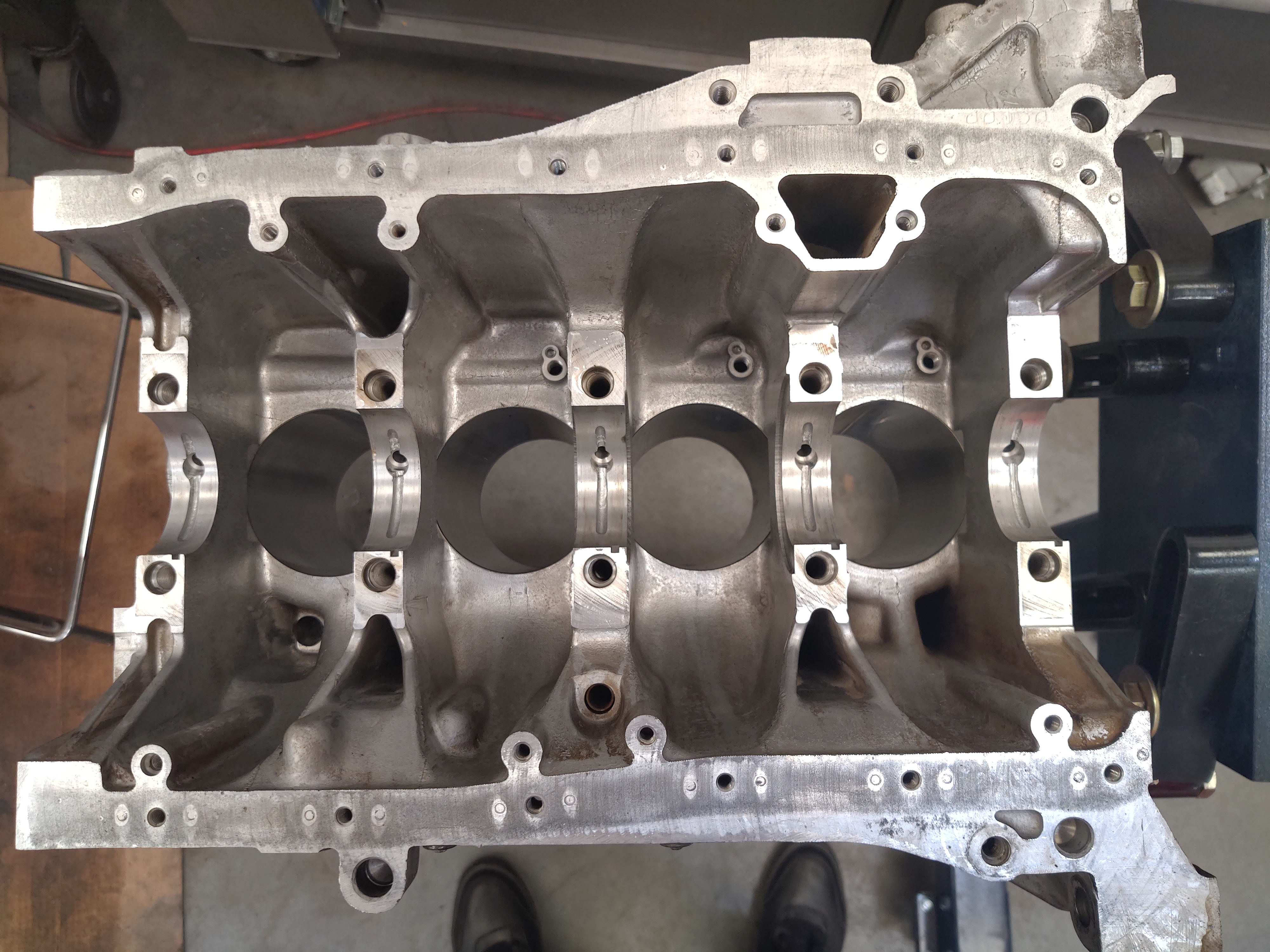

Dave7CDMTYPER wrote: Mon Jun 05, 2023 1:36 pm Quick update. I got my block back from Golden Eagle. Still waiting on the head from 4Piston.
I have yet to start assembly, mainly b/c I'm nervous about what to do about bearings. I recently met a guy who builds race cars. I might "hire" him to help me out with this step so I do it correctly.

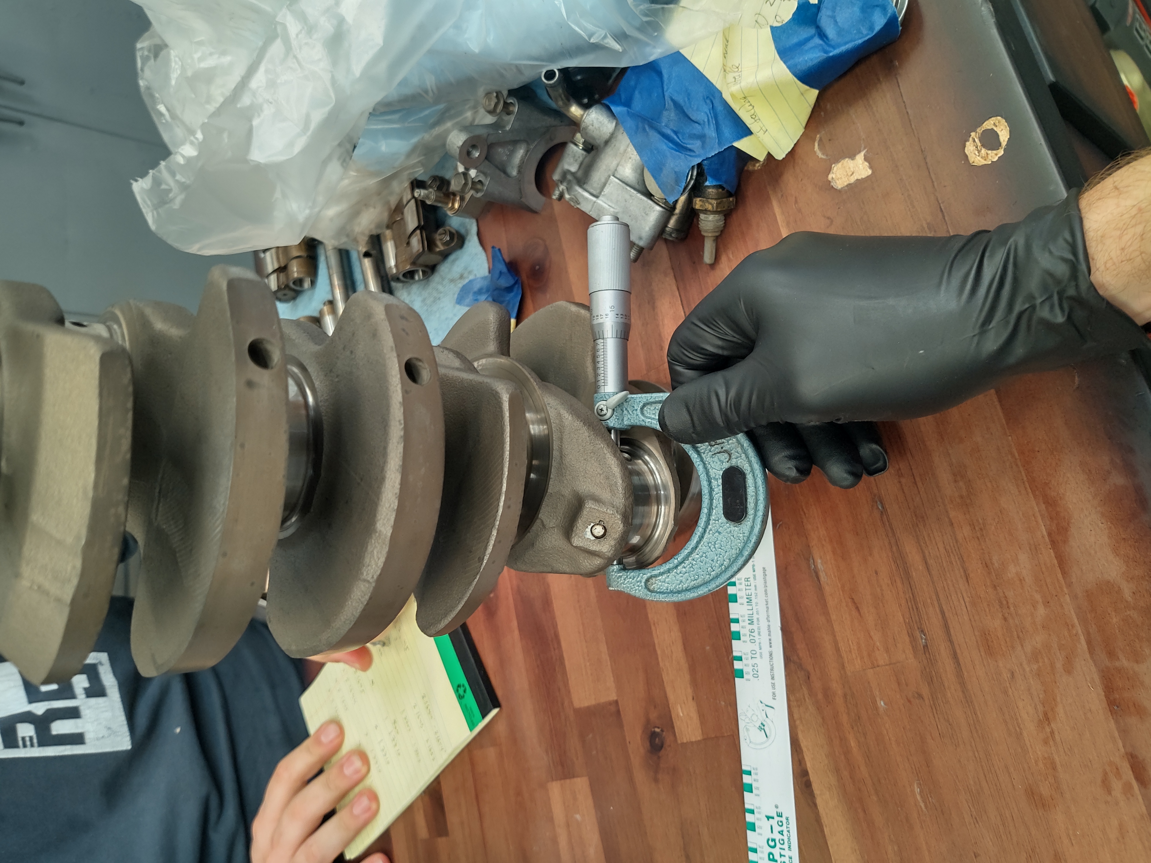

Post by Dave7CDMTYPER » Sun Jul 09, 2023 6:14 pm
Update! Starting to make progress again. I met a guy who builds race cars, he's going to help me assemble the engine. But I'll do it with him and learn as we go. He came over yesterday and we measured the crank journals. They are all in spec, so standard sized bearings will work. We figured out the color codes etc. I want to go with new oem bearings if possible, I'll see what Honda has in stock. Once I get those and maybe a few more new bolts etc for bottom end then we'll assemble! After bottom end is assembled then we'll do the cyl head. I still need to post pics of the cyl head after it came back from 4 Piston.
