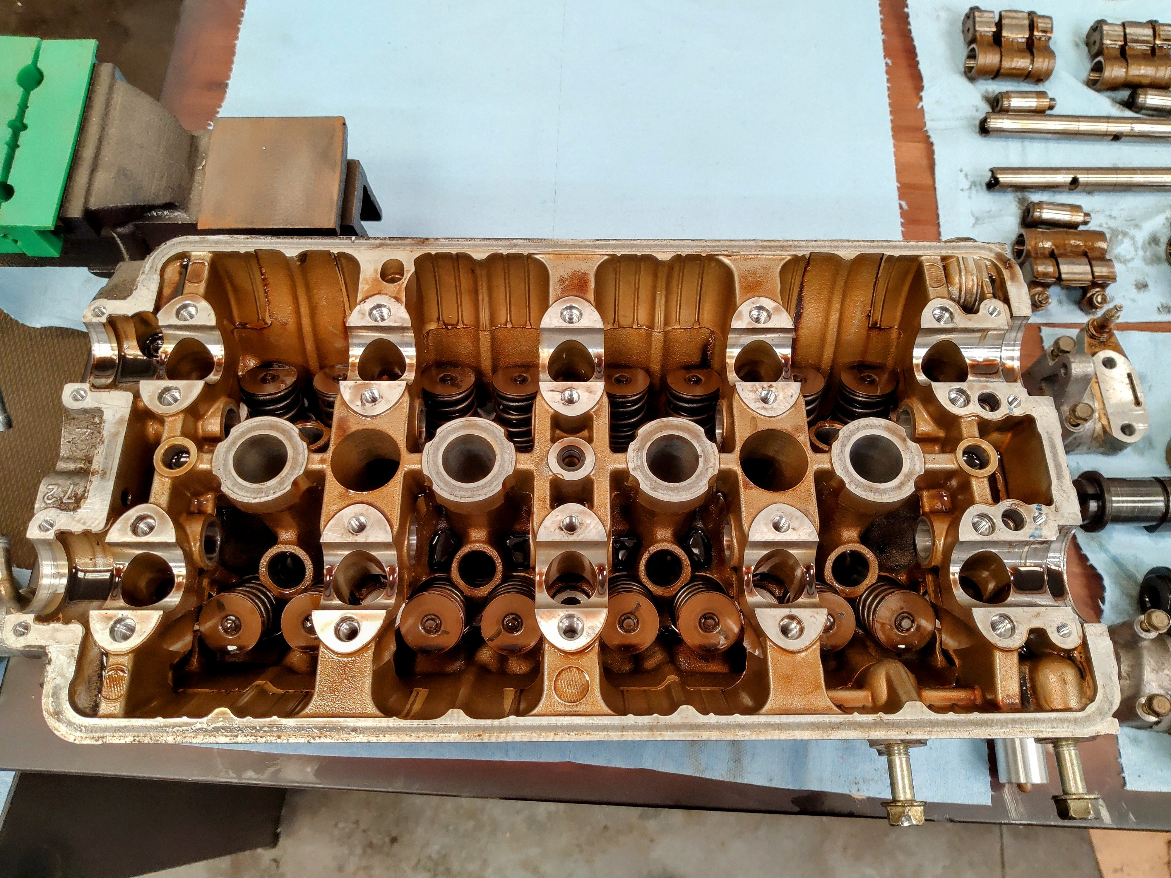

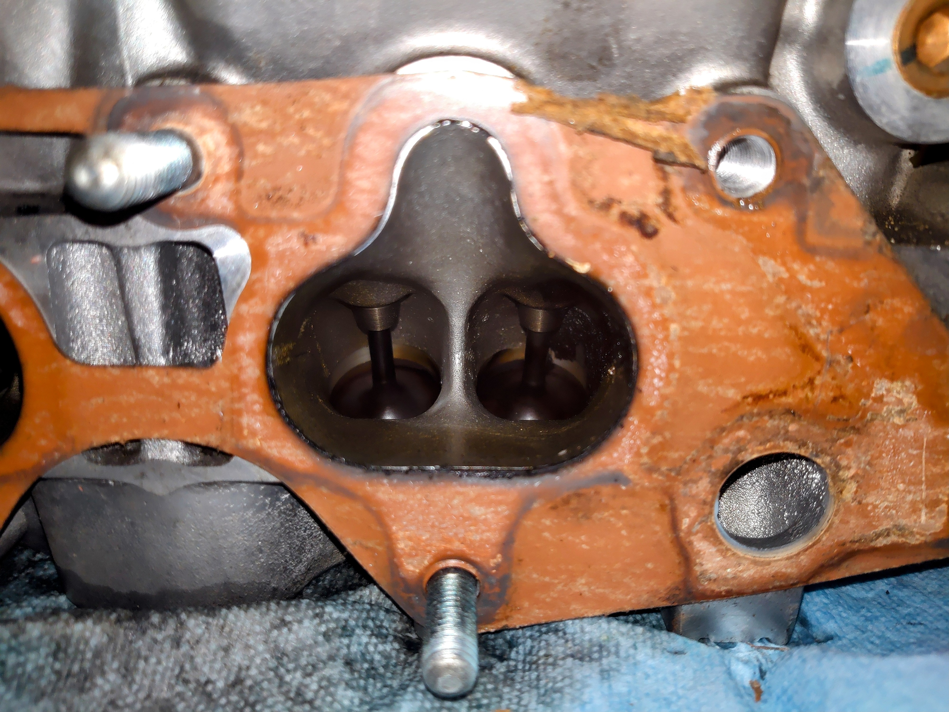

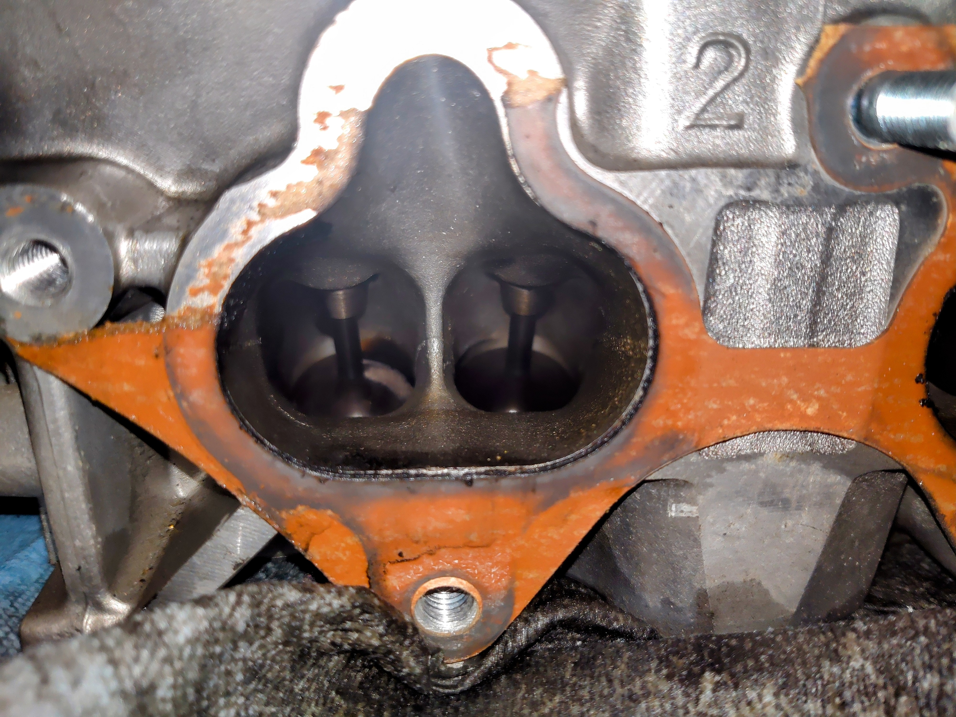

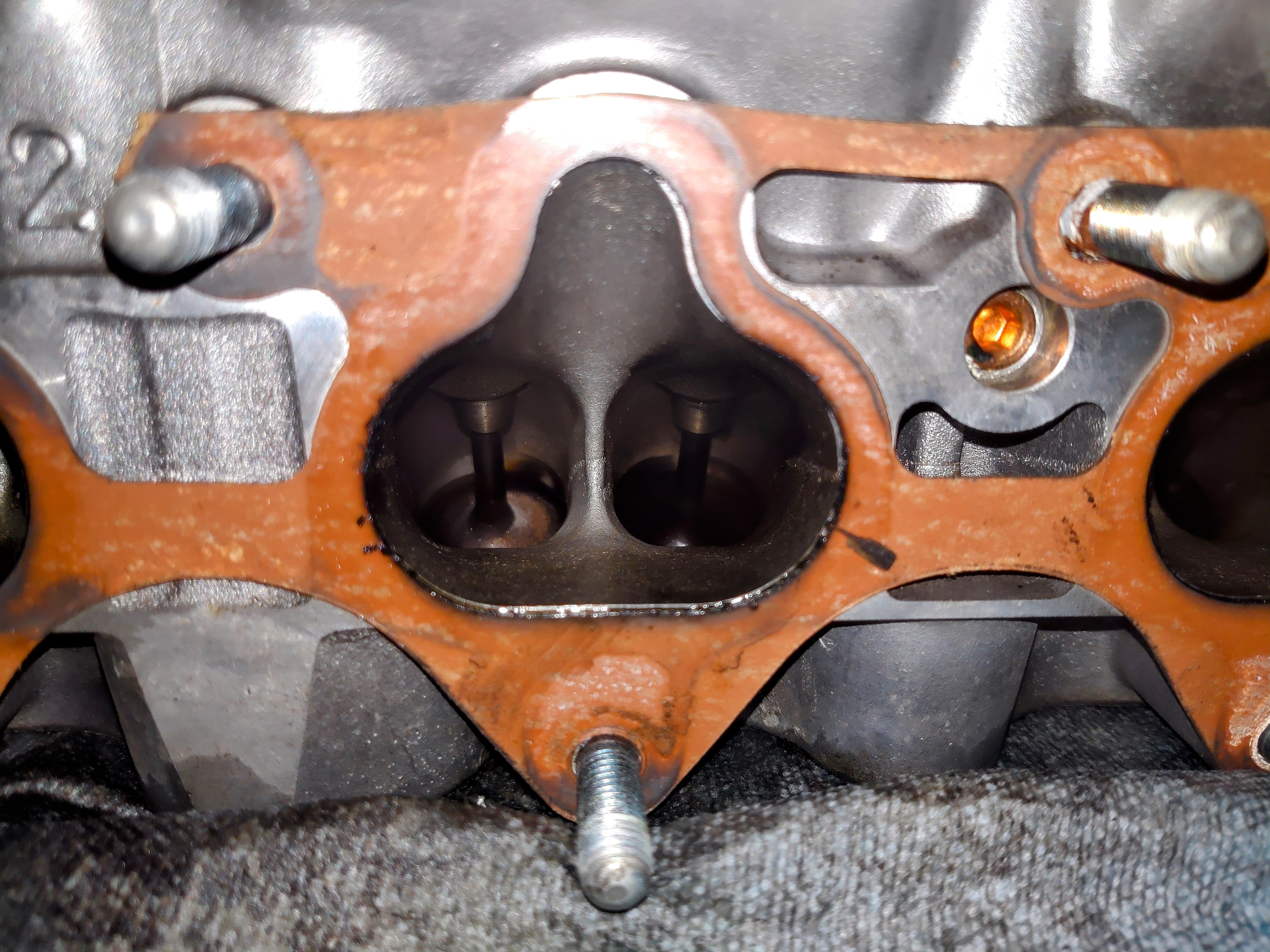

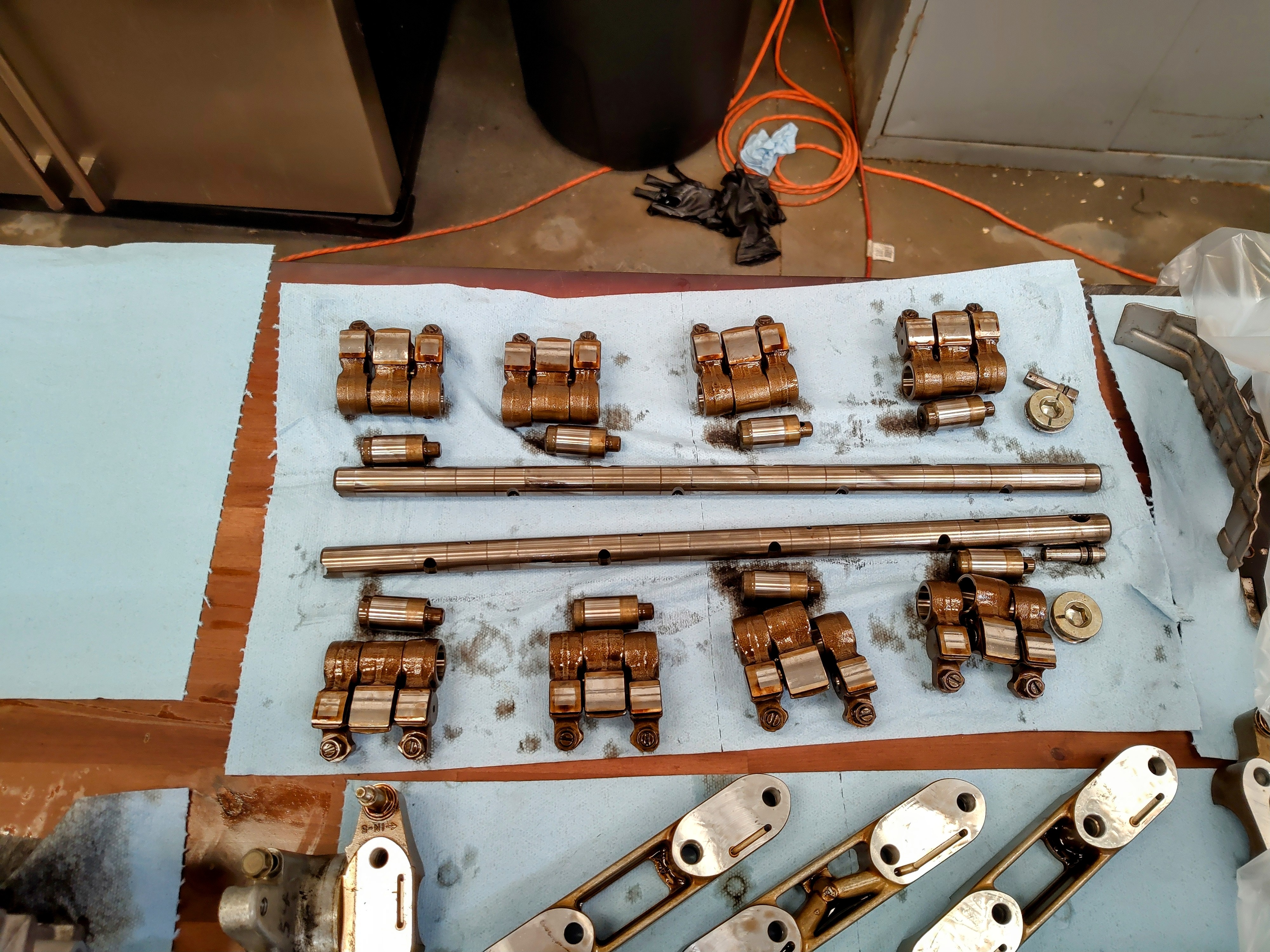

I removed the rocker arm assembly today. That was very satisfying for some reason. Next thing is to remove the valves and springs. I'm waiting on a spring compressor tool I ordered. I'm really excited to do that. As far as I can tell, the head is close to being fully disassembled. Then I will be able to consider what to do next with it in terms of machine work. If appropriate for my street/reliabillity build, I'd love to get it ported, and do the angled valve job. Below are photos and a video I took today of the intake ports, for what it's worth.

Here is a vid of the intake ports. Not sure if it tells anything about diagnosing the engine. Again, to my untrained eye, it seems pretty normal.
