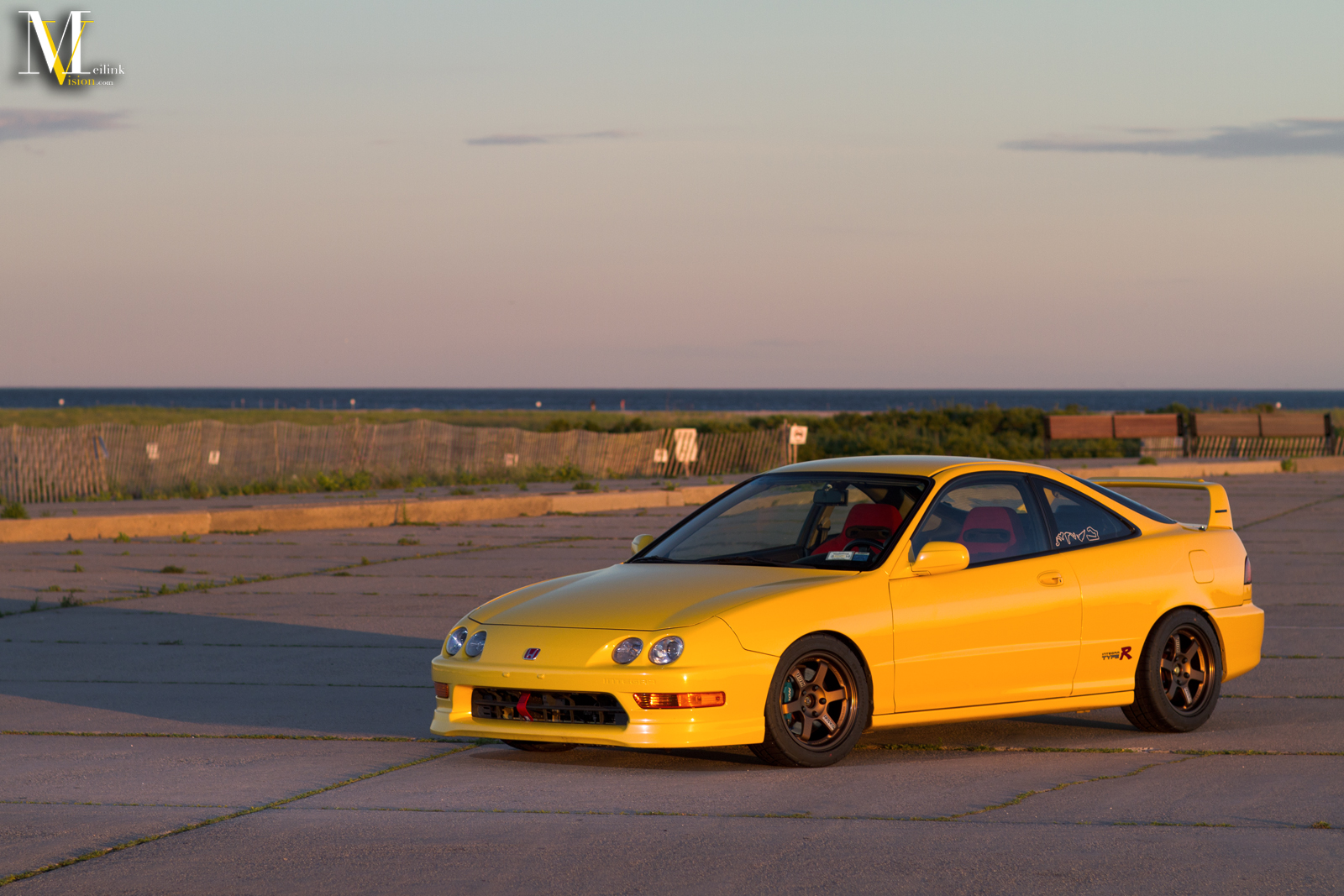

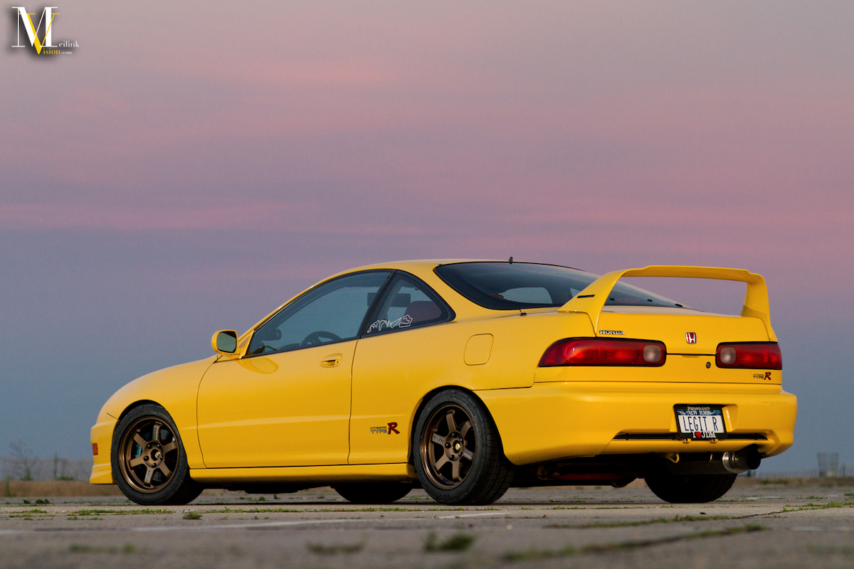

Considering how many of us are running 15x8 +35 I thought there would be more pictures in this thread.
This is with a 225/45 tire. My rears I had rolled previously for a different set of wheels so not sure how they would fit without the roll.
