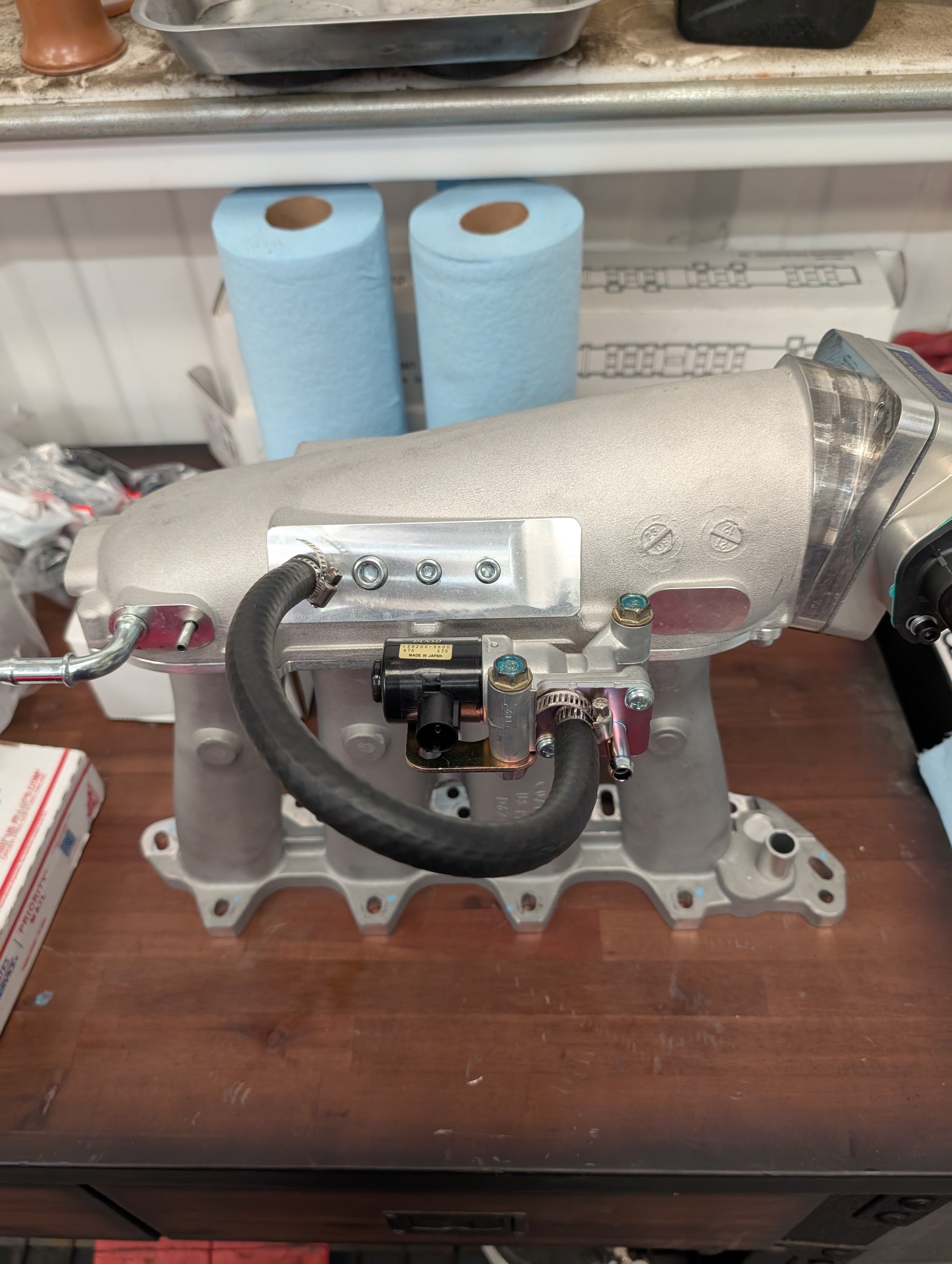

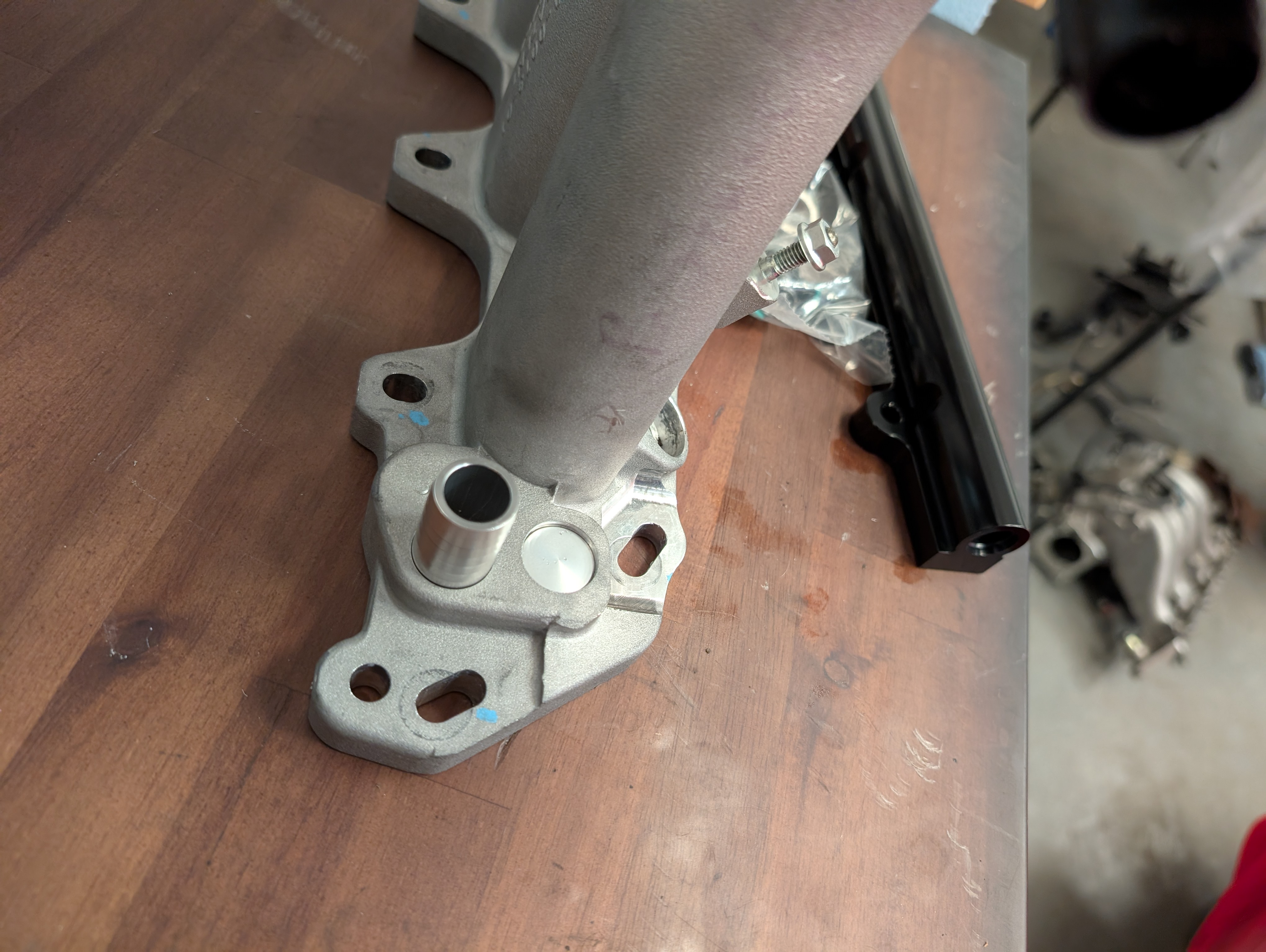

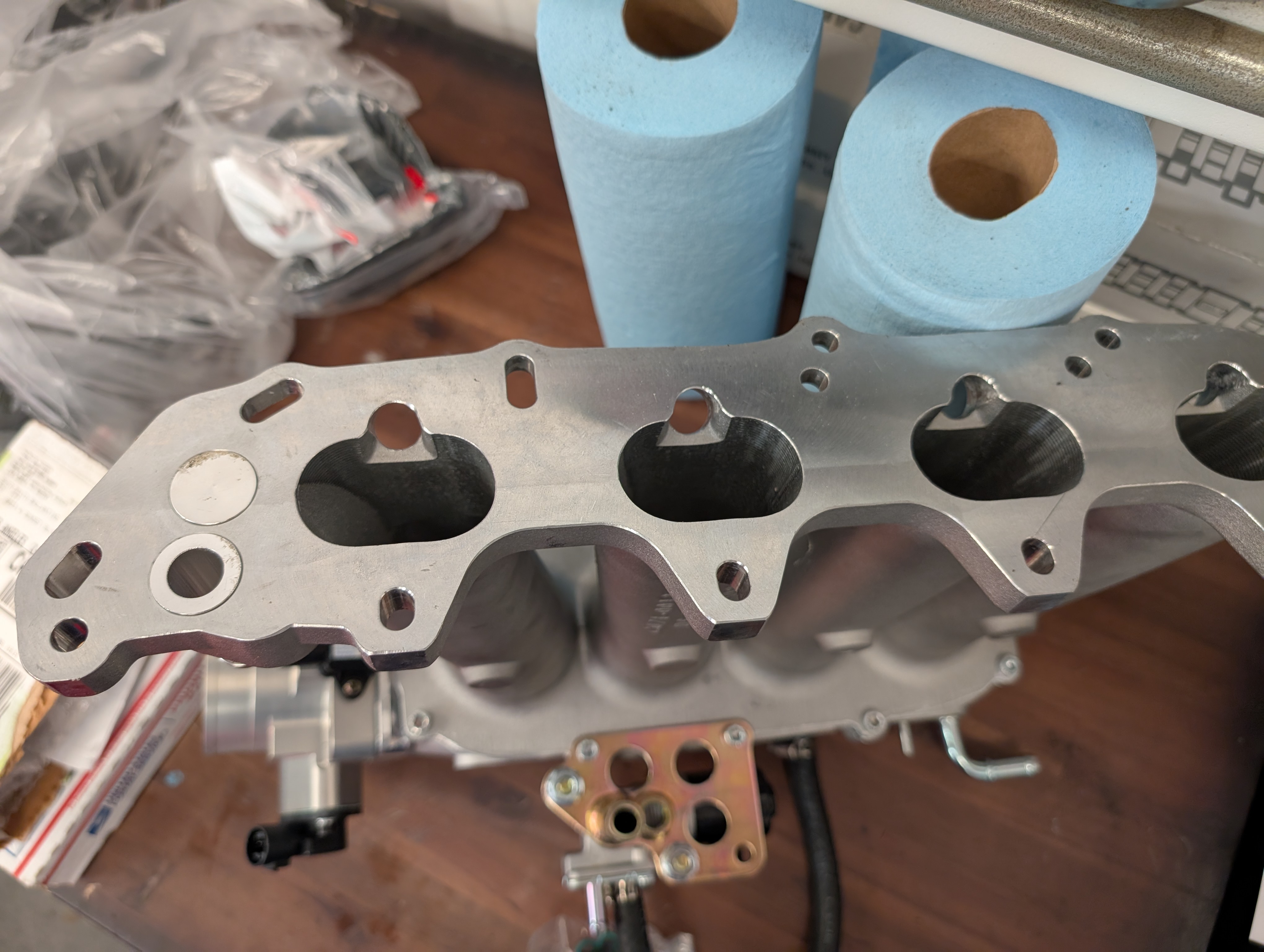

Made progress on the S2 manifold. I watched a few good videos of people installing the regular S2 manifold. Mine is different, but similar enough.
It's weird how the IACV attaches, on a bracket. Also figured out how to install the water pipe, and block off pieces.
Installed AEM fuel filter. I know this isn't really necessary, but I think it's kind of fun, nostalgia of the '90s. I think I may use the AEM fuel rail, both look good in black.

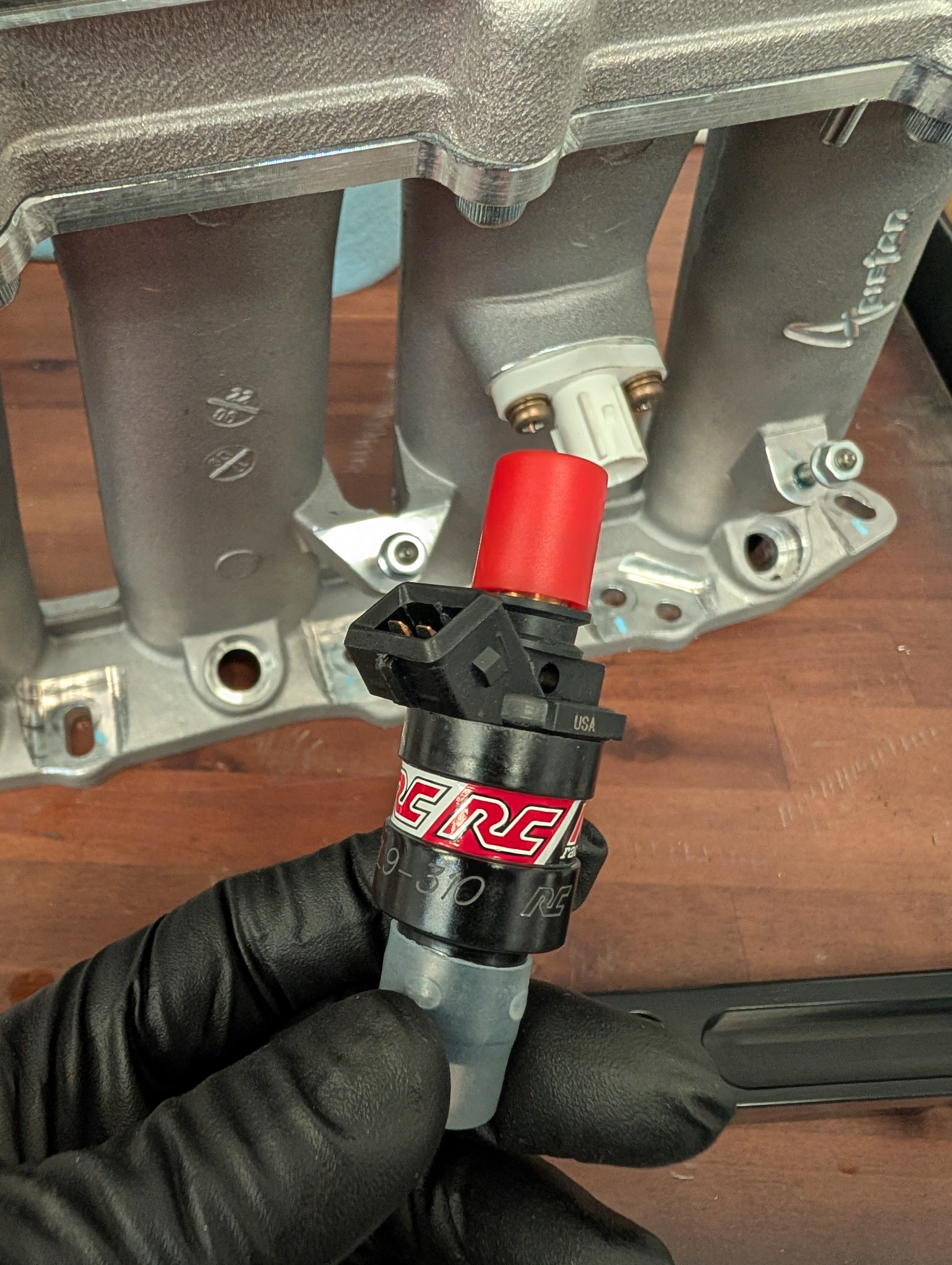

Deciding on which fuel injectors to use. I have some new/flow tested RC 310cc. But after a quick online search, I'm pretty sure there are better quality options.

Some fuel injector options I found:
https://fuelinjectorclinic.com/products ... 8774114374 (Thinking 365cc should be good enough?)
https://gramsperformance.com/fuel-injec ... -0500.html (550 cc is their smallest afaik, but might be a quality option)

Love that manifold, definitely a good option. I'd also suggest looking into bigger injectors if you're contemplating injectors anyway. nothing like leaving some room to grow w/ e85.
- Posts: 1182
- Joined: Tue Aug 15, 2017 2:17 am
- Badge Number: 01-1322
Ok good point. Not sure if I'll do e85, but at least will have a tune for race gas around 100 octane. What size injectors would you recommend?JDMJNKY wrote: Tue Mar 18, 2025 8:18 pm Love that manifold, definitely a good option. I'd also suggest looking into bigger injectors if you're contemplating injectors anyway. nothing like leaving some room to grow w/ e85.
Depends on your power goals really. 550cc-750cc should do the trick if it makes mid 200whp

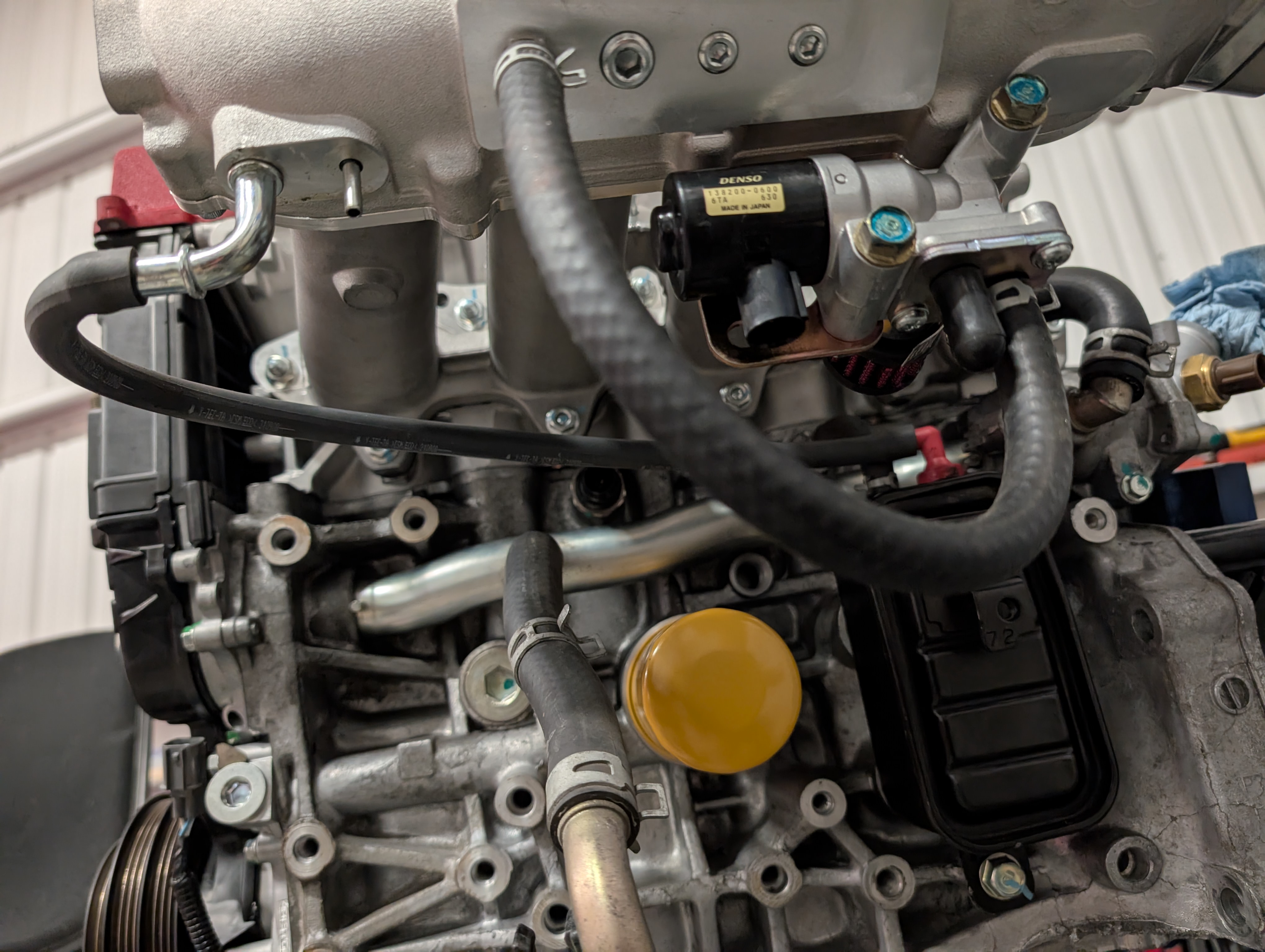

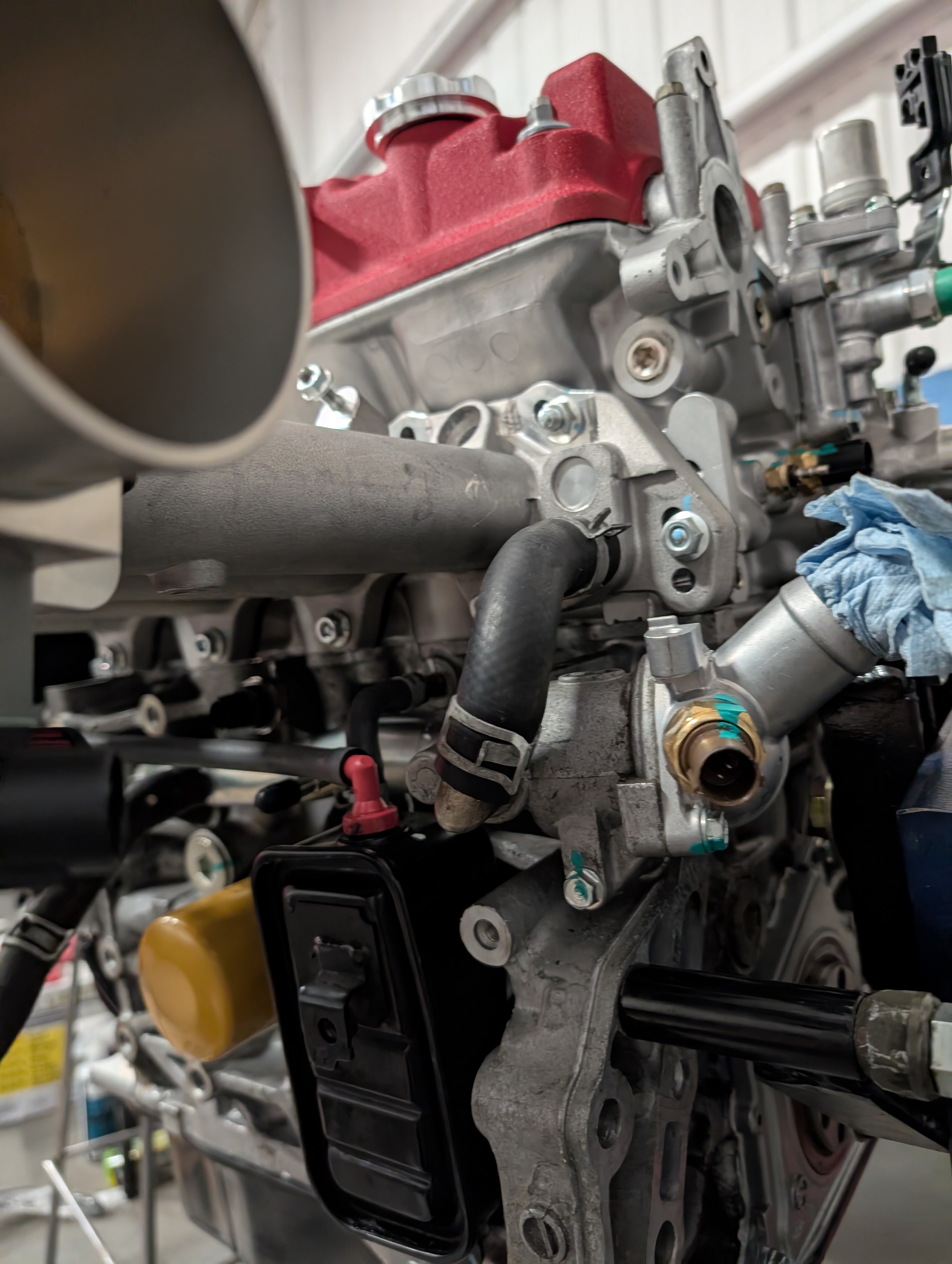

Made some good progress on the lines/hoses for the intake manifold. It took a while, but the most helpful way was to look at the factory service manual to see where the original lines go. Then figure out which ones are deleted for the S2 I/m. I realized that the weird throttle body coolant system will be deleted (which is good news imo), so I blocked off the outlets with rubber stopper things. I'll make sure they are snug and will put on clamps. I guess there is a chance of them leaking, but I think they will be fine.
I was able to see how the hoses route into the heater core and circulate back out. So I'm feeling pretty good, and that I understand most of the hoses and systems going on with the intake manifold.
I am trying to replace as many hoses as possible with new ones. The photos show some old and some new; the old ones are in place to remind me where they go.
I ordered some 550cc Grams injectors with plug n play wiring. I'll install those with the AEM fuel rail. I need to see if the stock fuel line will bolt up to that rail, or if I need to get an aftermarket one.
After the I/m and fuel stuff is done, I am pretty sure the engine will be just about ready to go back in.
