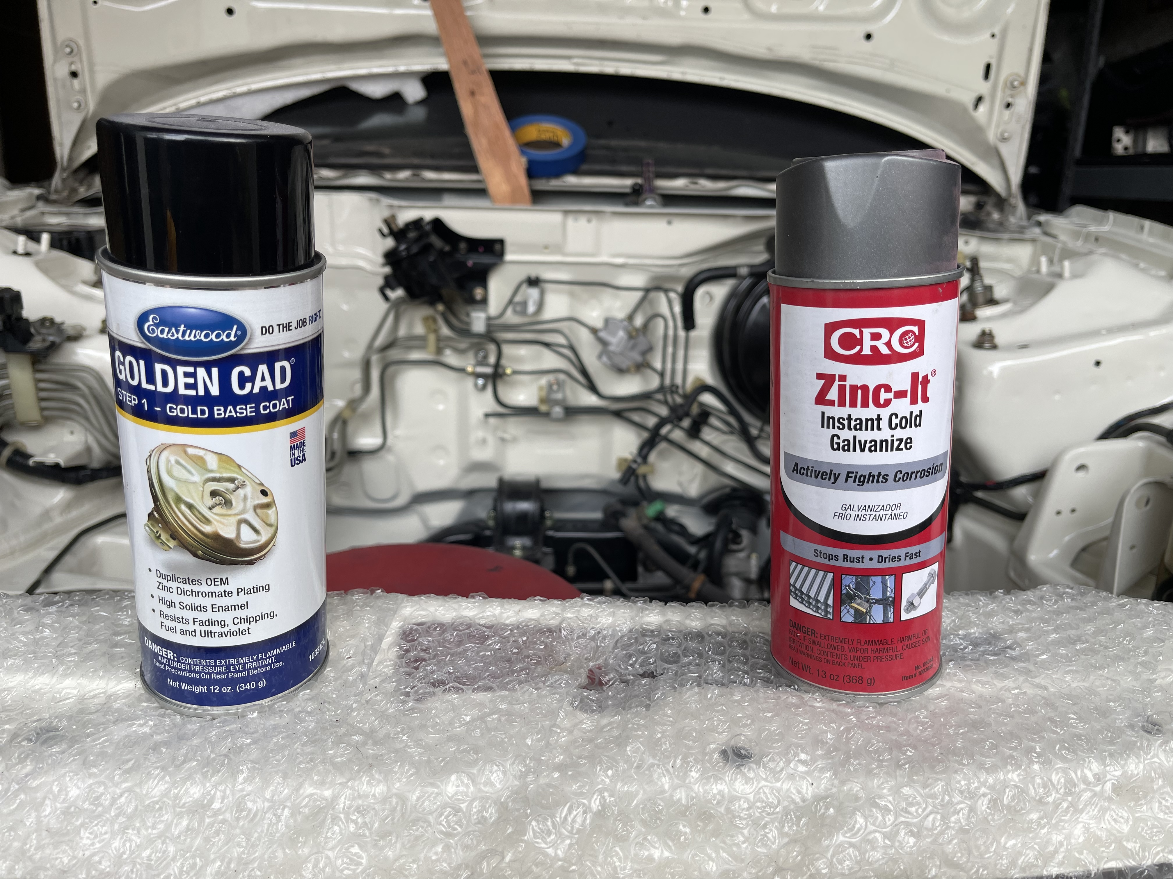

Summer is nearly over and now I have the urge to get the car on the road to enjoy it before the roads are covered in snow and salt. Waiting for the perfect time has come and gone for a few years now.

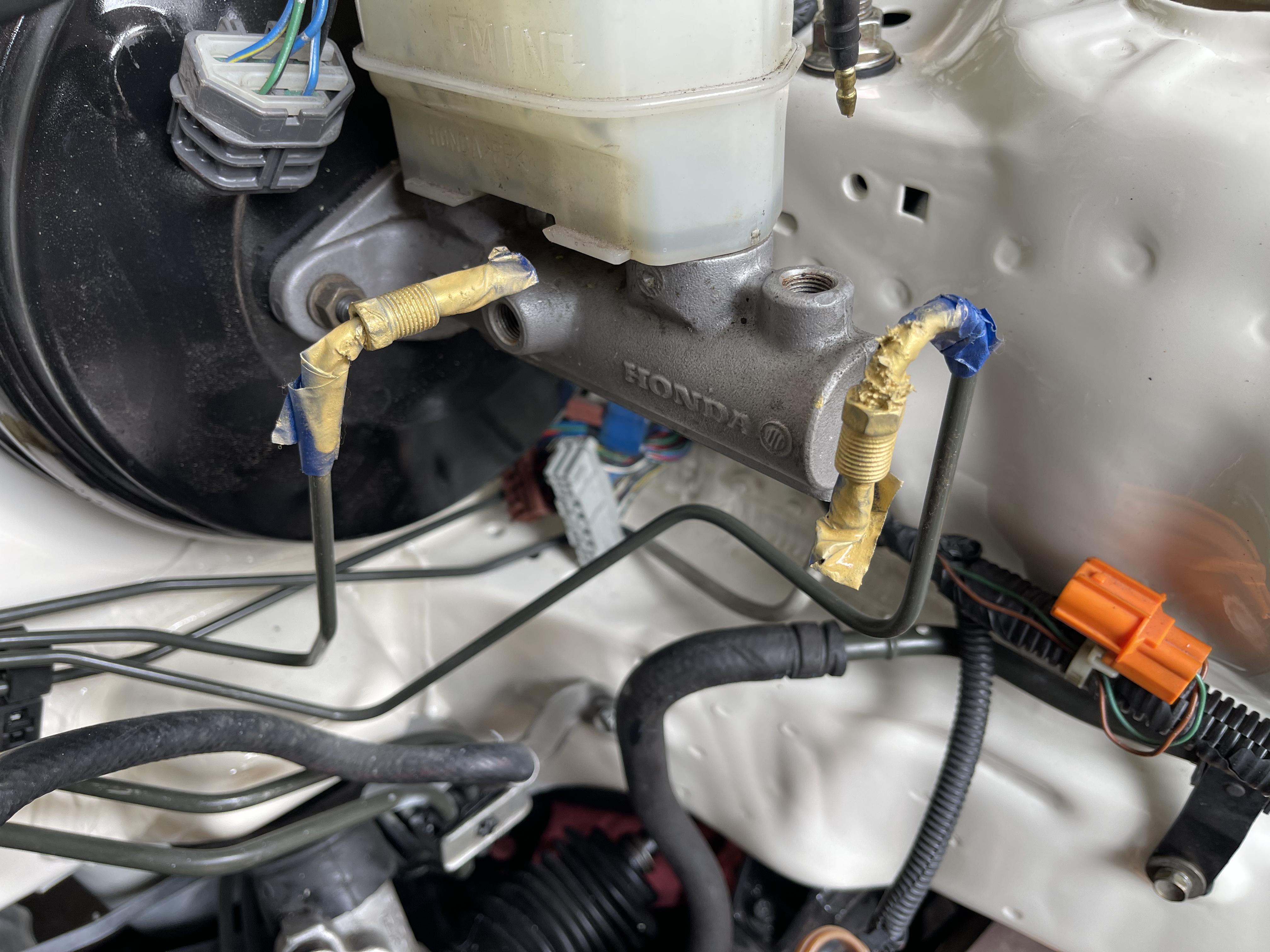

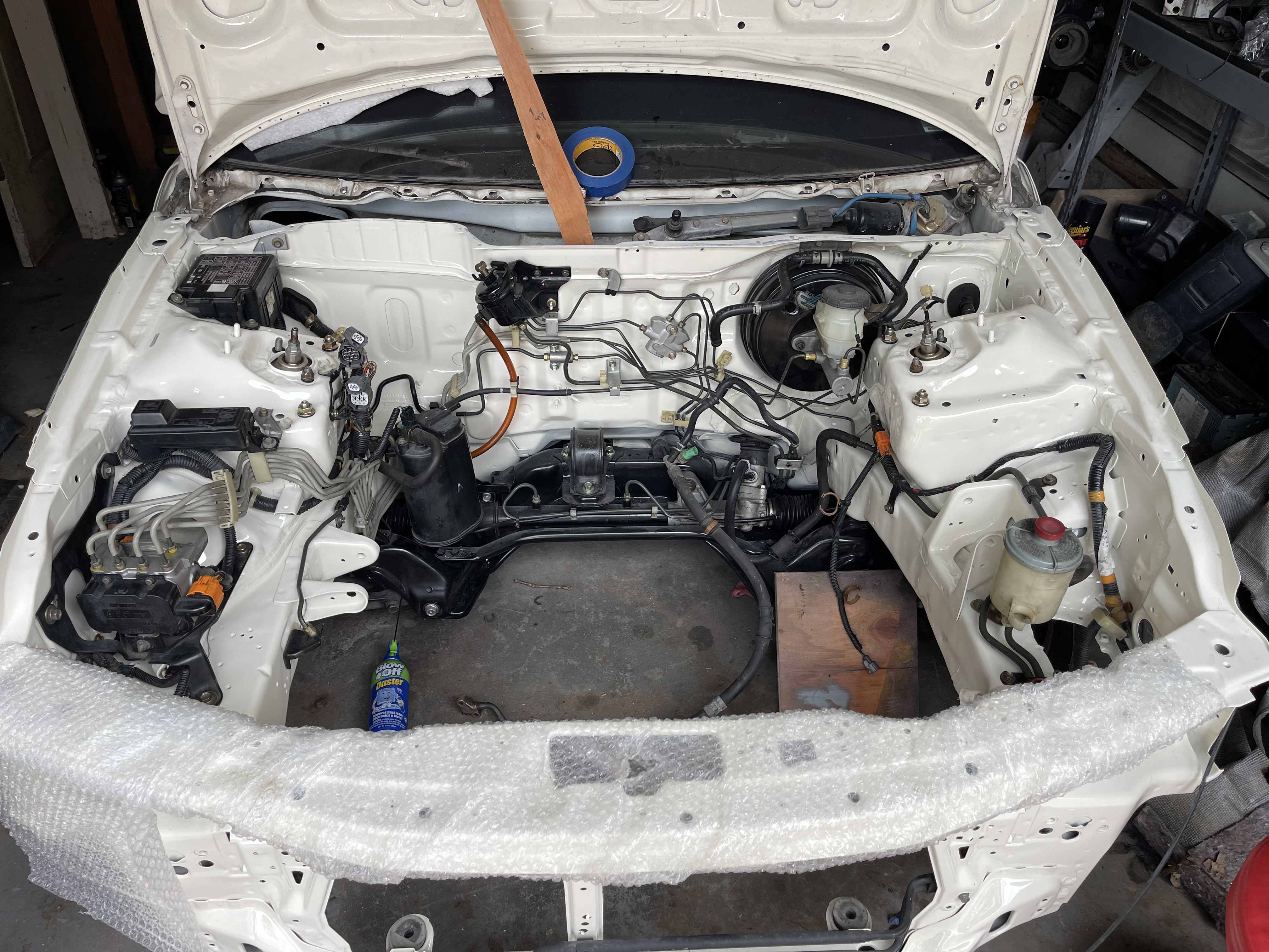

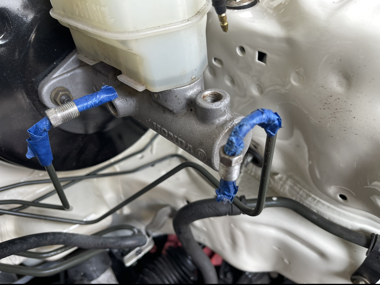

First order of business is to get everything back in the engine bay. I have not worked on this car since it was painted over a year ago! Luckily, I am somewhat organized and sorted all the bolts, brackets and grommets in ziplock bags. (Supreme bags were a gag gift a few years ago, so I put them to good use!) Looking back at pictures from when I first disassembled the car, I then installed the ABS module as well as the hardlines. I also installed the clutch hardline, fuel lines and power steering lines. Can't forget about the booster and evap canister too! Onto the harness, this was when I realized I should've installed the harness first before anything else, because it is routed under the ABS module and the windshield wiper plug does not fit with the booster in. Took a bit of finesse but the harnesses are routed.. for the most part. Last thing I addressed before calling it a day was the brake fittings what had been damaged by brake fluid. In total there are three fittings that needed attention, the two on the brake master, and the one on the clutch master. These were my three options:
1. Wire wheel the fittings and coat it with Zinc coating and then try to color match it.
2. Clean off the fittings with a wire-wheel and clear coat them
3. Carefully cut off the flared-end of the brake lines, insert new fittings and re-flare the lines.
I figured I'd try out my first option on these two and go from there... Finish looks just like gold spray paint and I hate it! So next time I am working on it, I will move onto option 2 and if that also fails I will have no option but to cut the line and just get new fittings.

Re: 98-0148 (From Rice to Nice)
Man legit updates! Can't wait to see how that CAD kit turns out.
Thanks! Unfortunately the CAD came out terrible. Essentially it’s just gold paint.JDMJNKY wrote: Mon Aug 07, 2023 11:42 am Man legit updates! Can't wait to see how that CAD kit turns out.

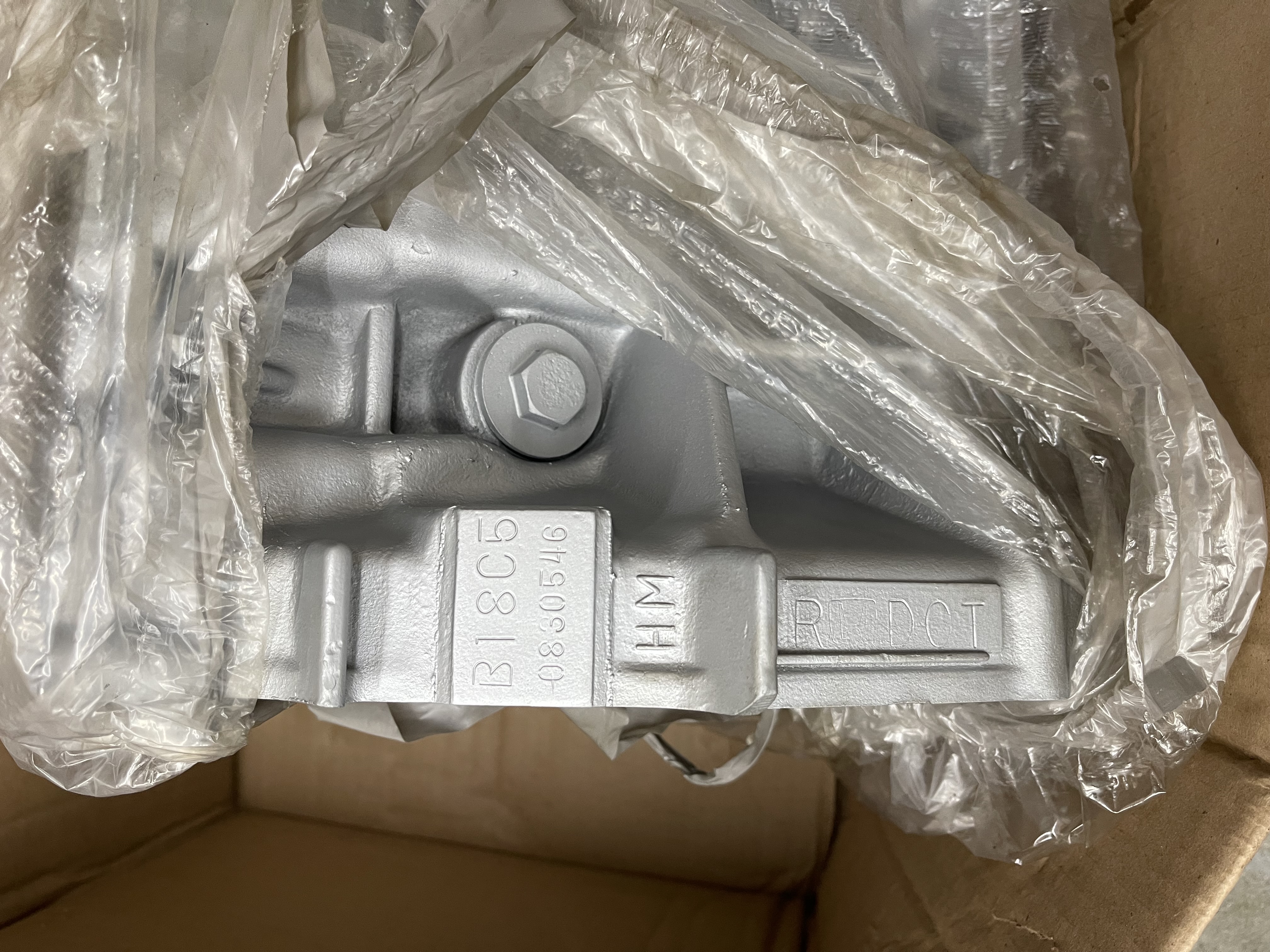

There’s a HUGE part I’ve been leaving out and I think it’s time I let you all in on my secret… this is going to be long!
As you all know I went to great extents to piece together an RDOT engine and transmission for my car as I bought it as a shell. Well over the course of the last 6 years I’ve been in semi-constant communication with the seller of my car, basically keeping tabs on the original parts to my caR. He basically used the ITR as a parts car for his ‘99 Civic Hatch, taking the suspension, Drivetrain, steering column, Seats, Armrest with badge plate, and even my lock cylinders along with much more.
2017-2019: I bought some minor parts back from the seller and asked various times for the major parts but he always declined. This was all during the time I was putting the car together for the first time and then took it apart and was contemplating the next steps (selling or full blown restoration).
February 2020: He reaches out to me, he crashed the car and did not have the time to fix it. He traveled a lot for work, just had a baby and was expecting another. So this was my chance to buy all my pieces back, but he was not interested in selling the parts separately and was firm on selling it complete. He mentioned that he was only interested in selling me the car as the parts belonged to my caR. We negotiated for a couple of days but ultimately we were very far apart on prices. Mind you, this was during the spike in ITR prices so he was definitely trying to come up. I was also in the mist of building my newly acquired bottom end so I was not in a tight spot where I HAD no choice but to buy it.
2020 - November 2022: The seller and I lost contact. Throughout this time I did reach out a few times but we couldn’t come to an agreement. We last spoke on January 2021. Luckily, reached out exactly 5 years after I bought the shell from him. This time he was pressed to sell it, he was relocating out of state and was not interested in taking it with him. Surprisingly, his price had not changed at all, At this point I had already collected and assembled majority of the parts for my caR but I figured it was my last chance to get my original parts. We settled on a price and came to an agreement on when the car will be delivered.

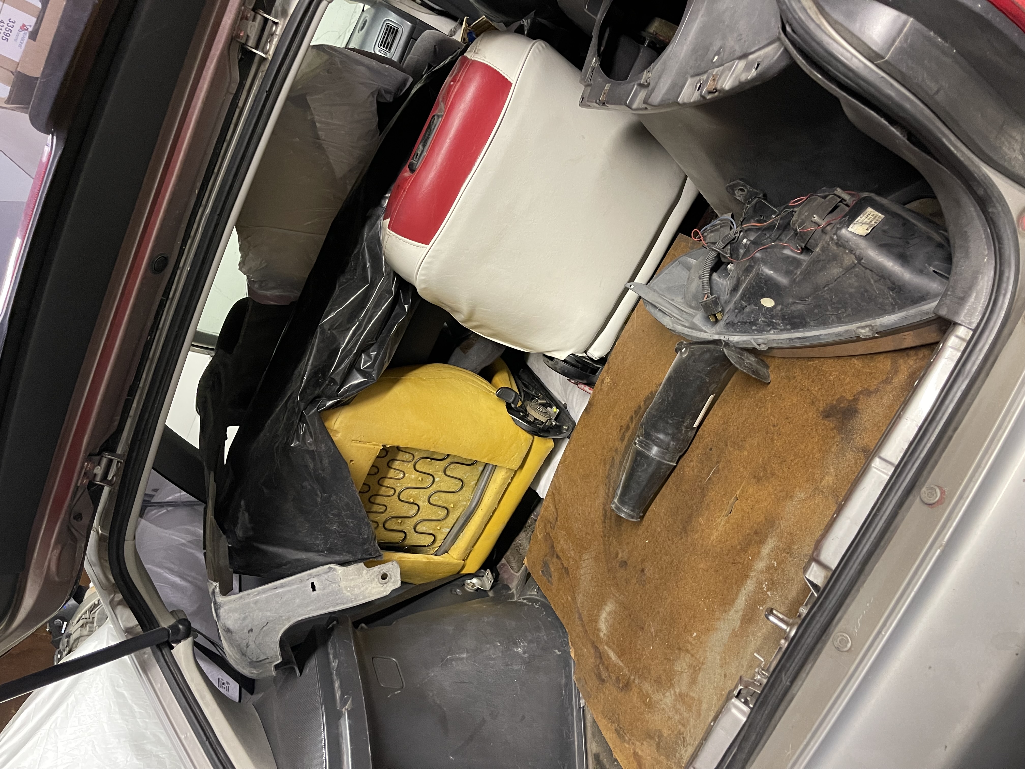

January 2023: After yet another torturous encounter with transport companies, the car was delivered! I had officially taken ownership of the original parts for my car! I couldn’t have been happier. Although my car will never be classified as “all original” I think it’s such a great feat knowing I have as much as the original parts as I possibly can.

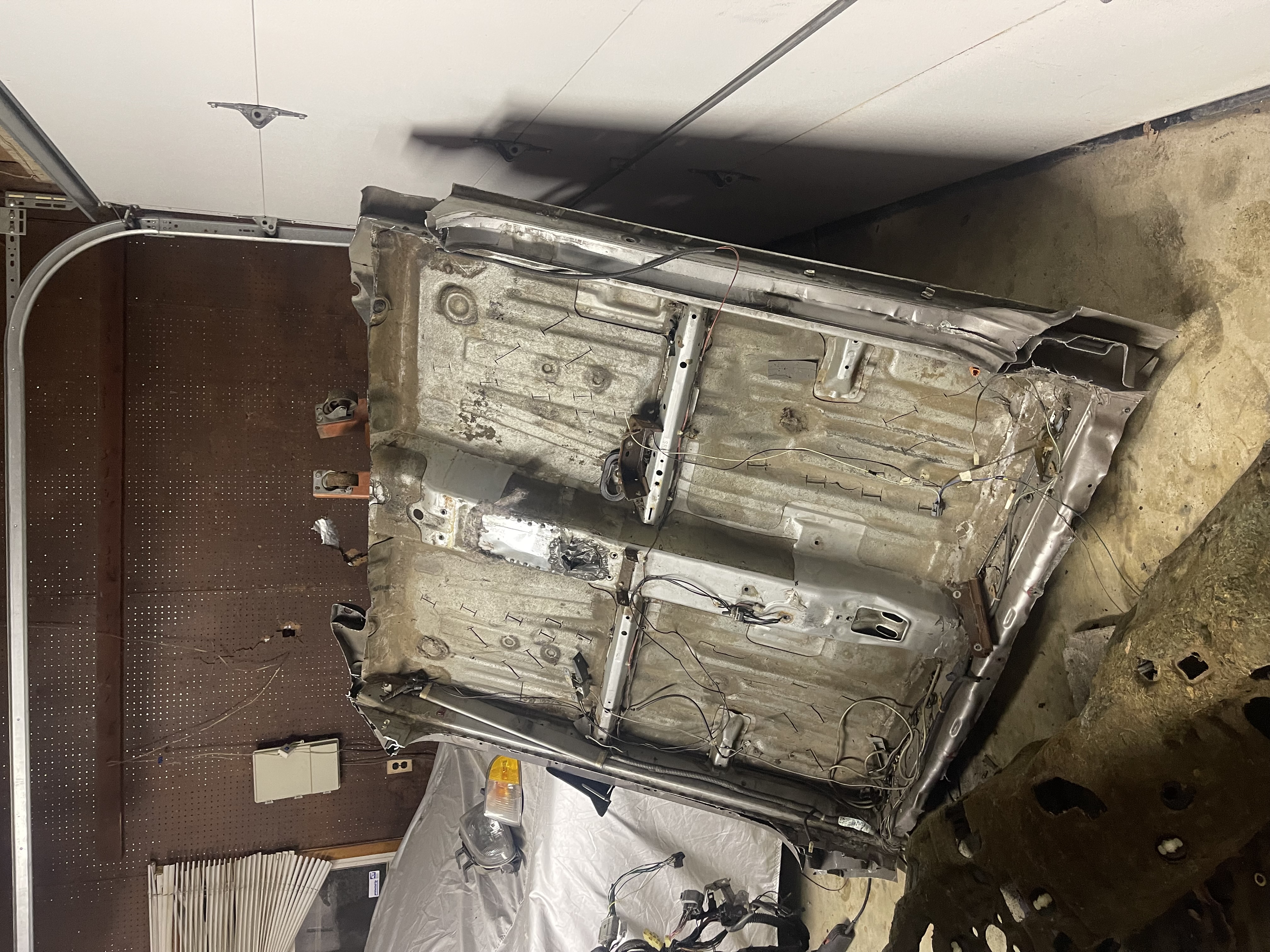

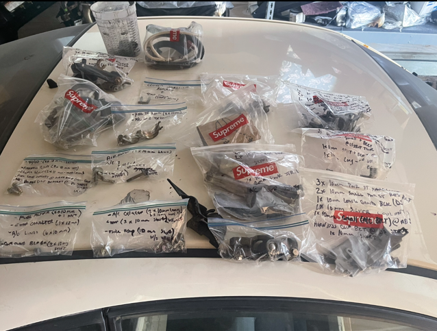

February 2023: I removed all the original parts that belonged to 98-0148 and parted out the rest of the civic. I got extremely lucky as I made back roughly $1500 off of a totaled shell! People bought everything, even the floor board. Whatever was left I junked.
Here are some pictures of the ‘99 Civic and all my parts:

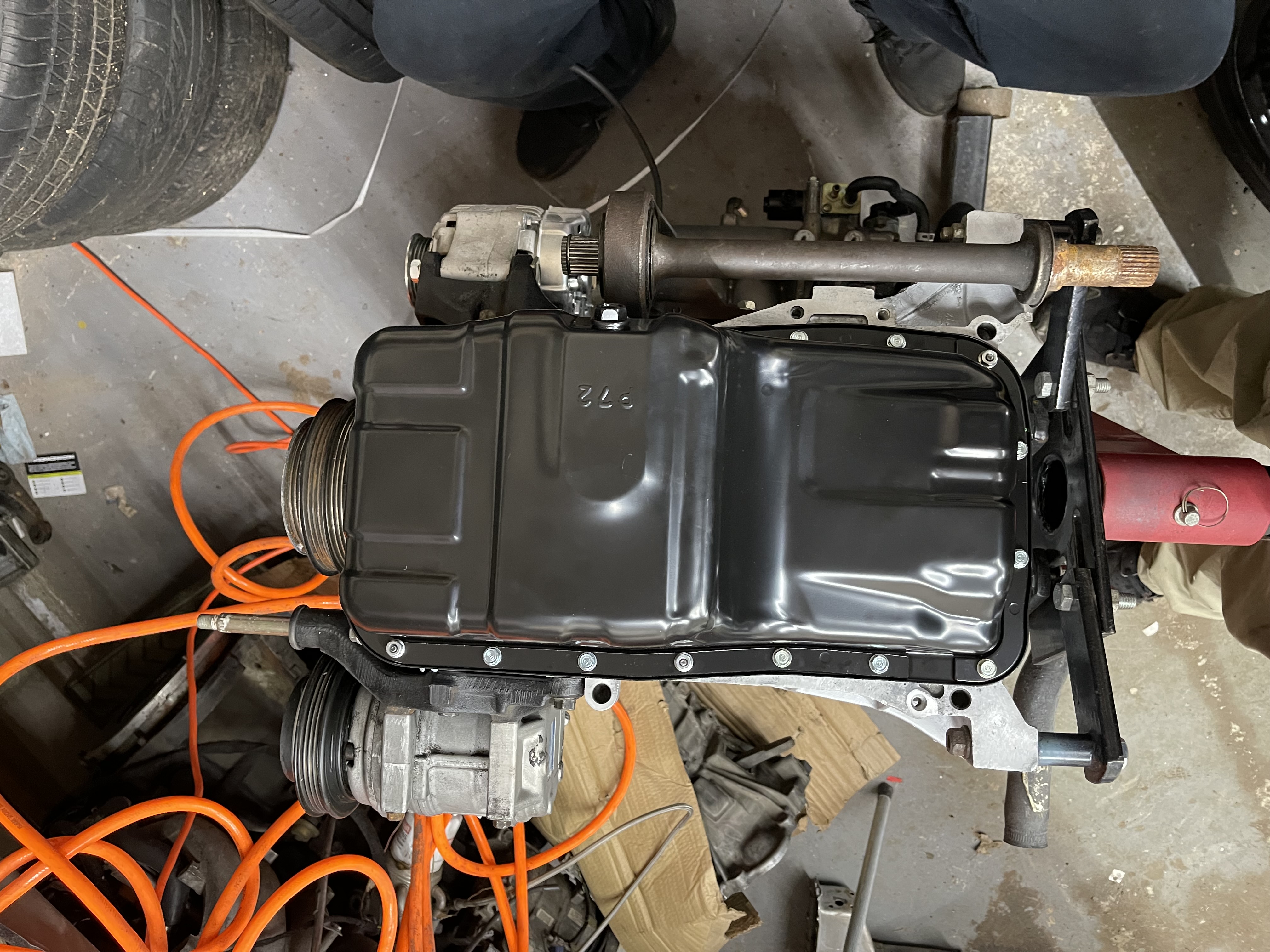

Had some time to finish the engine bay, so now it’s time to bring the engine and transmission over and put it back where it belongs!
With the help of my brother, we were able to get it mounted into the car. With all the excitement of putting the original drivetrain back in the car, this is when we realized the post mount had been changed. So, I then had to remove everything off the side of the engine to replace the mount, which luckily I had on my Rdot block.
In retrospect, this would’ve been a great time to replace the timing belt and water pump since everything was out of the way. However, I am on a tight timeline to have the car up and running by the end of the month to surprise my friends with it. They hate the fact that I put the car together and took it apart all in the span of 4-5 months and are always pushing for me to get it running again. We’re going to be spending a weekend up at the Poconos for my uncles birthday (also an ITR owner) and I figured this would be a nice surprise for them.
After putting it all back together, and tightening the mount. I was left with this:

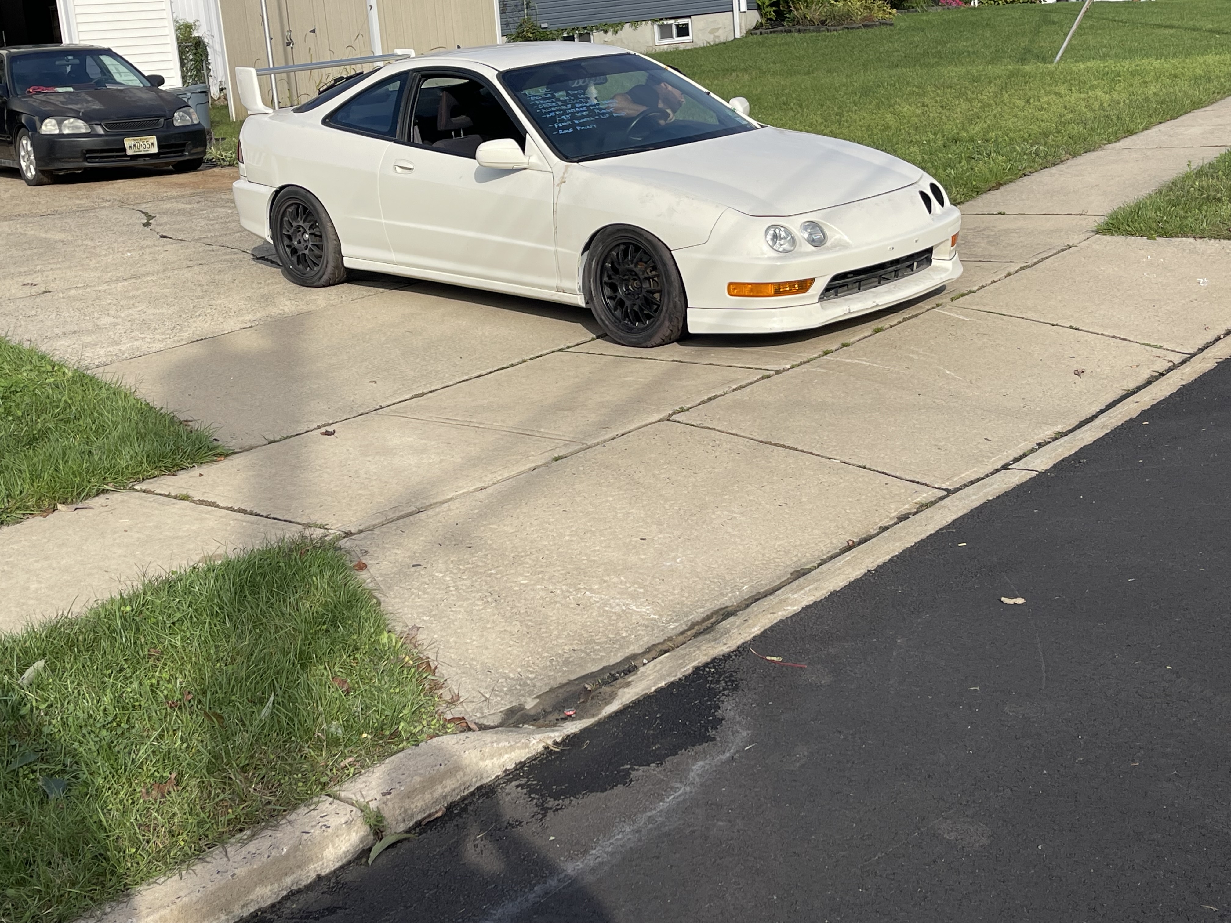

With the caR at home I had access to work on it with any free time I had. My cousins came over and we were able to appropriately bleed the brakes. Per the manual on a car with ABS you should start at the front wheels to release most of the air out of the lines. we also kept the car on and it worked out great. We continued tackling the list of things to do until I was left with buttoning the car up.
After 2 late nights, the car was ready for the road. So it was time to reinstall the body panels. Only problem here was that I lost one of the headlights and I put my stock ITR spoiler on another project which has since been sold, the only other spoiler I had was a Mugen Gen II that I’ve been hoarding onto. So I made the executive decision to put it on the car, and I couldn’t have been happier with the outcome!
Mandatory gas station photo shoot lol:
It was a great feeling, filling the car up after 4 years! I drove the car around town, and got on it a bit and boy does this thing rip!
Love the wheels! I miss the OG offsets. Car looks great with the Mugen wing. Congrats on all of the progress
