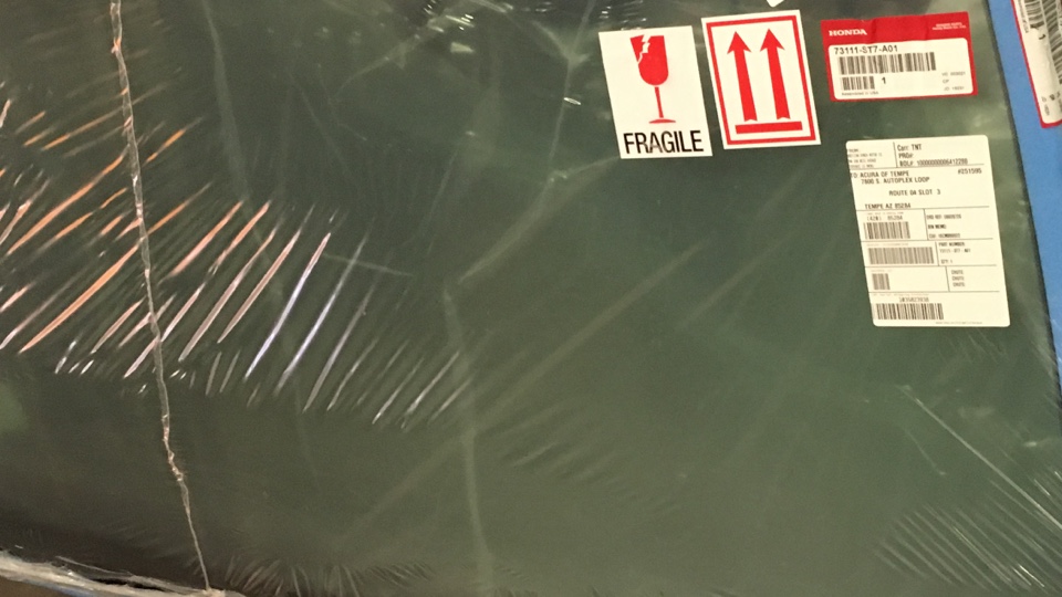

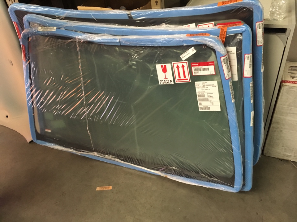

Post by Dc2-ProductionS » Mon Feb 21, 2022 8:55 am
OEM windshield has landed. Will be going in this week! Found my box with all the OEM trims and covers in it from 2017. :D
More pictures to come...
Stay tuned... 8-)

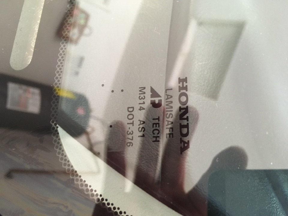

[attachment=2]B13C92B7-0FAA-4A73-B329-93944AFF1D4B.jpeg]
What’s the ol next to the ap stamp? My 98 didn’t have that. Some of the earlier years have a green tint vs. what Acura and Honda calls a blue tint on the windows. Either way in for the windshield polish and install.
