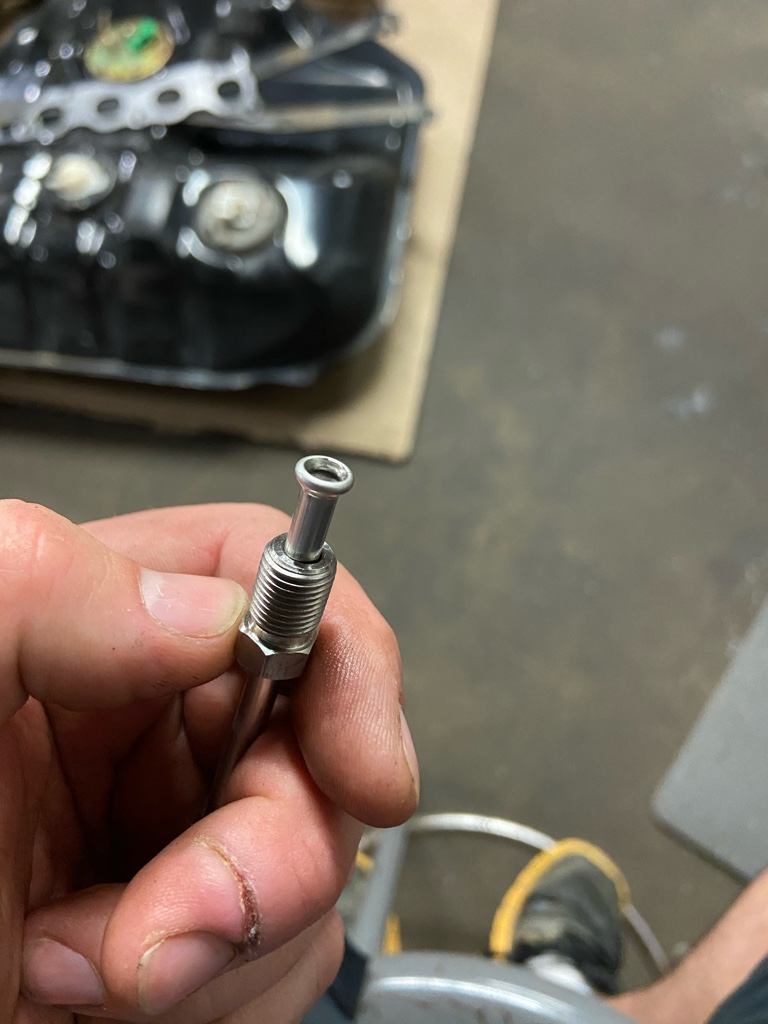

Picked up an eg fuel sending unit with a banjo bolt connection rather than a barb connection for the fuel feed. Made it easier to run the entire line out of the braided hose.

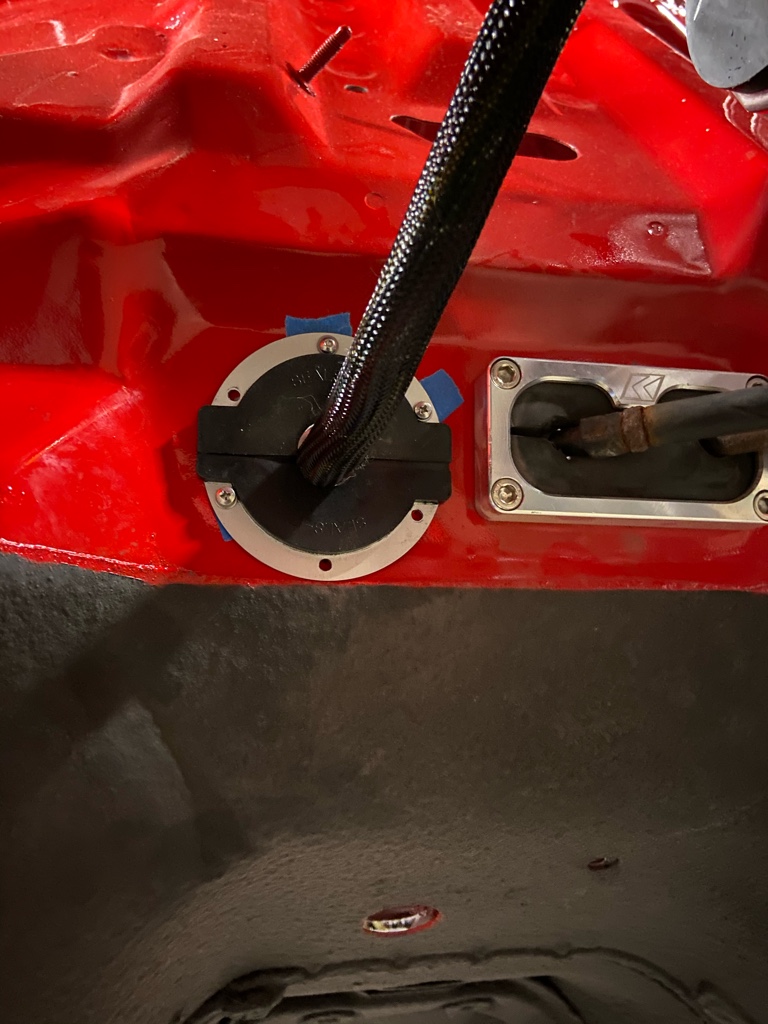

This is the grommet I picked up from Checkerd Sports for the engine harness. Wanted to do a fancy mil-spec connector, but didn't want to put out the coin for one of those harnesses.

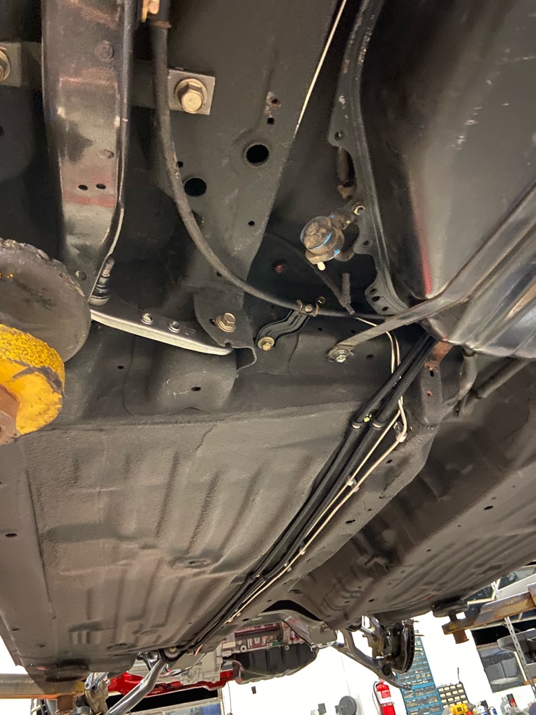

Pretty pleased with how these lines turned out under the car. I ended up putting some rivet nuts into the floor to add a couple more clamps to hold the lines up nice and tight. I mentioned it before, but putting in rivet nuts get addicting!

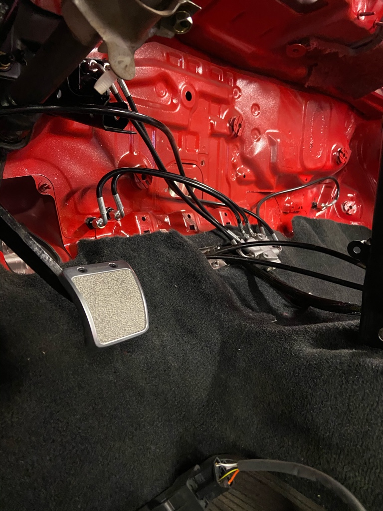

Here's how the brake lines turned out under the dash after the rear bulkheads were put in the firewall. I'm really happy with the flex lines. Made getting the heater and blower boxes back in easier without having to worry about rubbing hardlines.

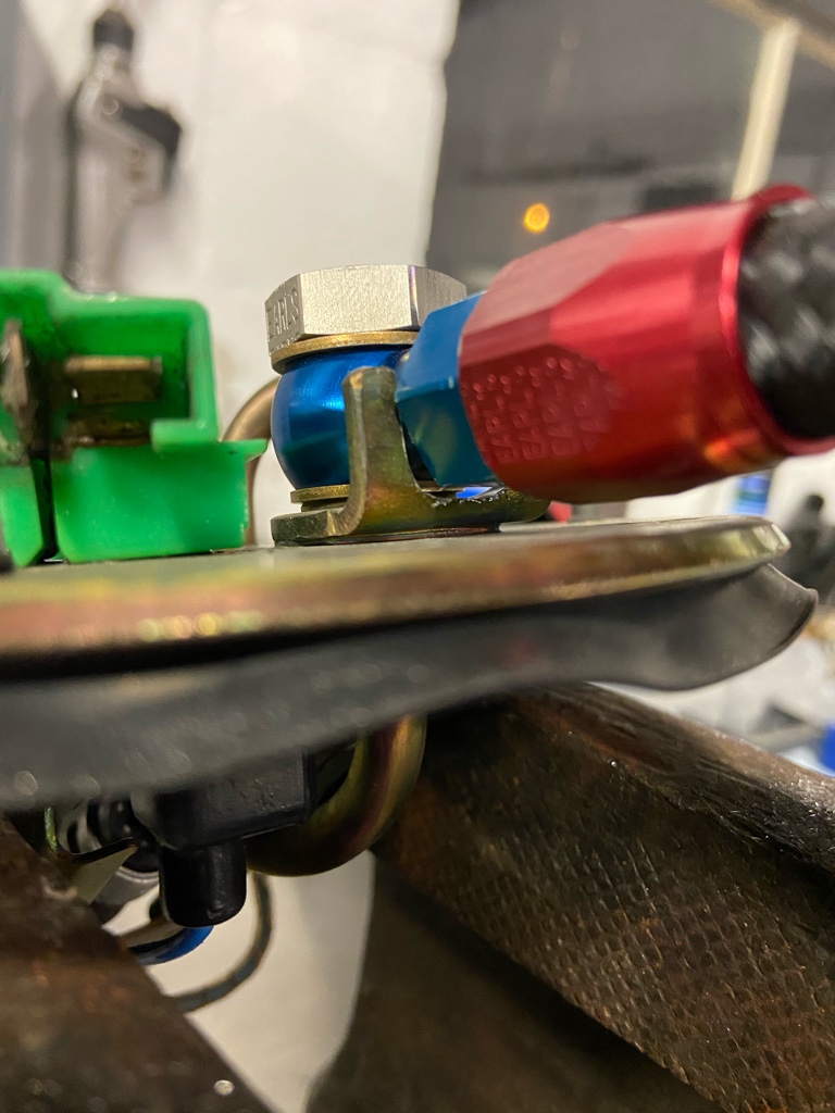

Fuel an lines hooked up. I ended up slipping the return line over the barb for a short while. The conversion fitting from barb female to an was backordered for the longest time.

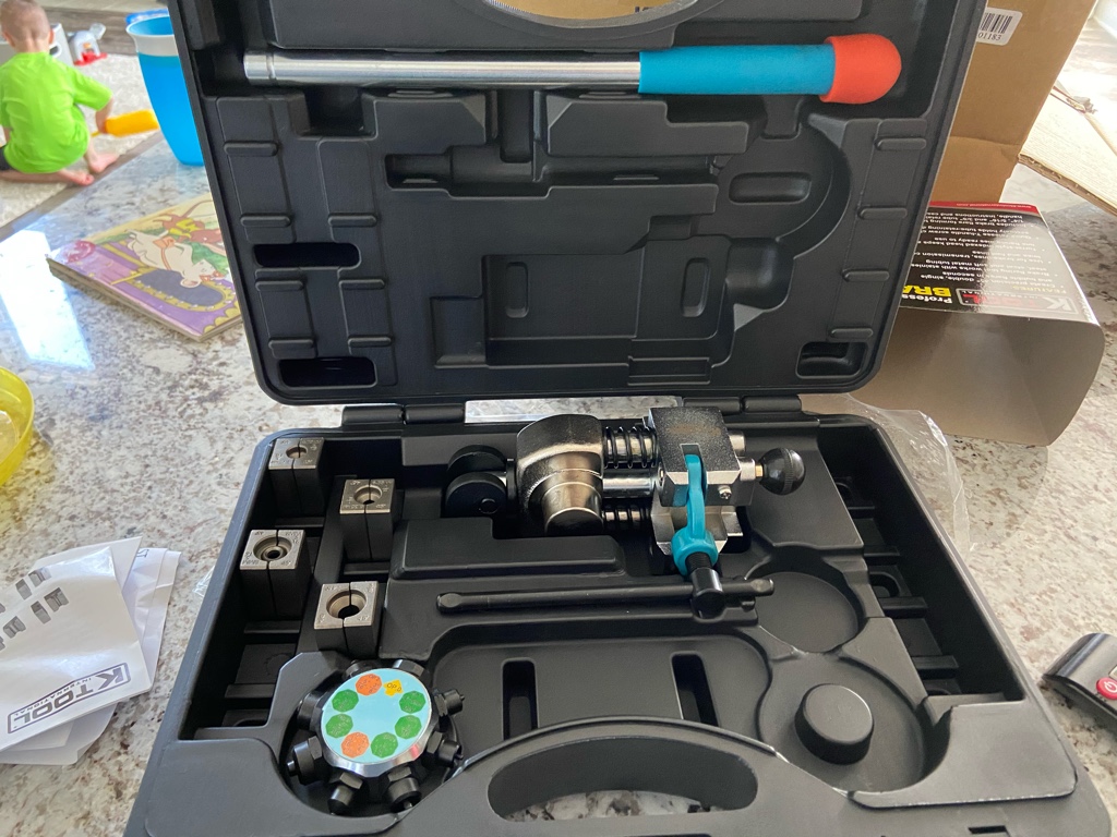

If anyone ever wants to make brake lines, this flare tool is a must. I had a cheap harbor freight flare tool that worked okay for regular steel lines. When it came to stainless, that tool wouldn't even begin to make a decent flare. Ordered this off amazon (eastwood and summit have very similar tools as well). I also bought the single flare die for this tool to make the flares on the rear line firewall an bulkheads.
Flares turned out awesome on the lines, and ended with 0 leaks after I was finished. Was pretty pumped with that after this was the first time I'd replaced/made every brake line on a car.

Flare tool that made making the flares so quick and easy. Super easy to have consistent nice flares.

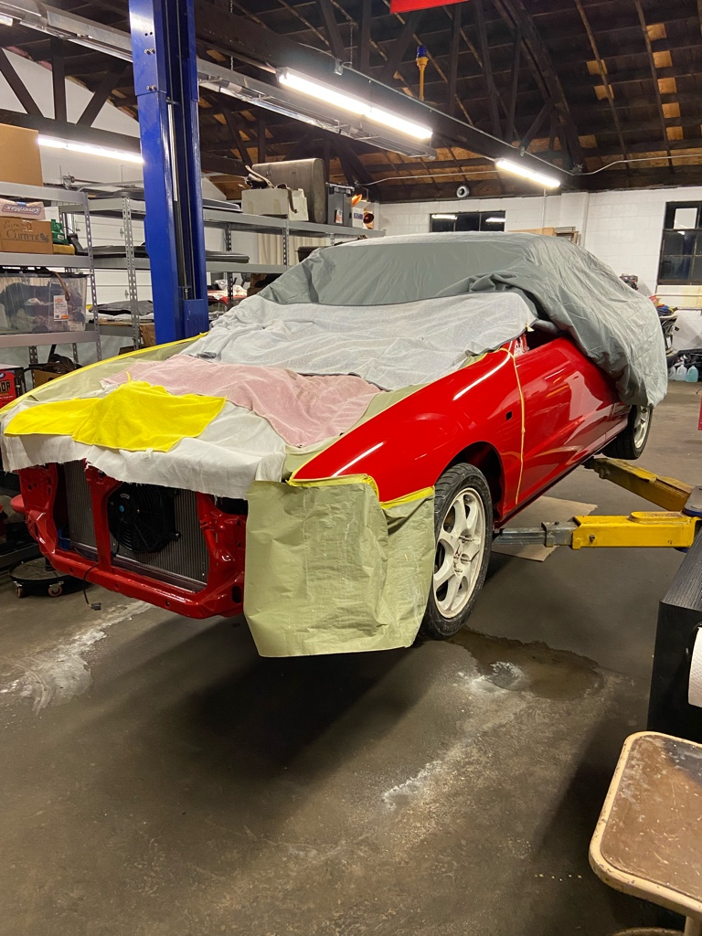

Now that the car was getting closer to being able to start, I decided to get back to the body work side and prep doors, fenders and the hatch for paint. Here are the pieces after being prepped and getting ready to get some primer.
Primer sealer applied
Base color applied

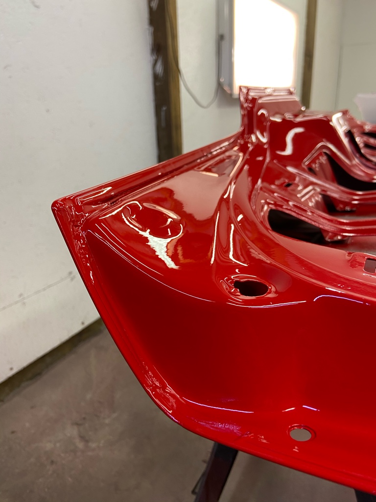

Really happy with how the clear flowed out fairly flat for minimal prep on the back sides of the panels. Am I crazy for base/clearing where interior panels will clean up? Maybe, but it would have driven me nuts to know the car wasn't all 1 color.

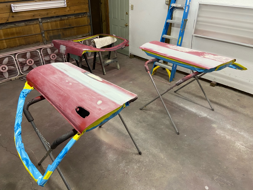

Fenders needed some massaging after we put them in primer. Gotta thank my friends dad for all the help. He's insanely good at body work, and is incredibly picky so he's one person I know will get it as good as it can be.
Hinges and fender brackets hung and ready for paint.
Just about ready to start hitting the outside panels with primer surfacer.

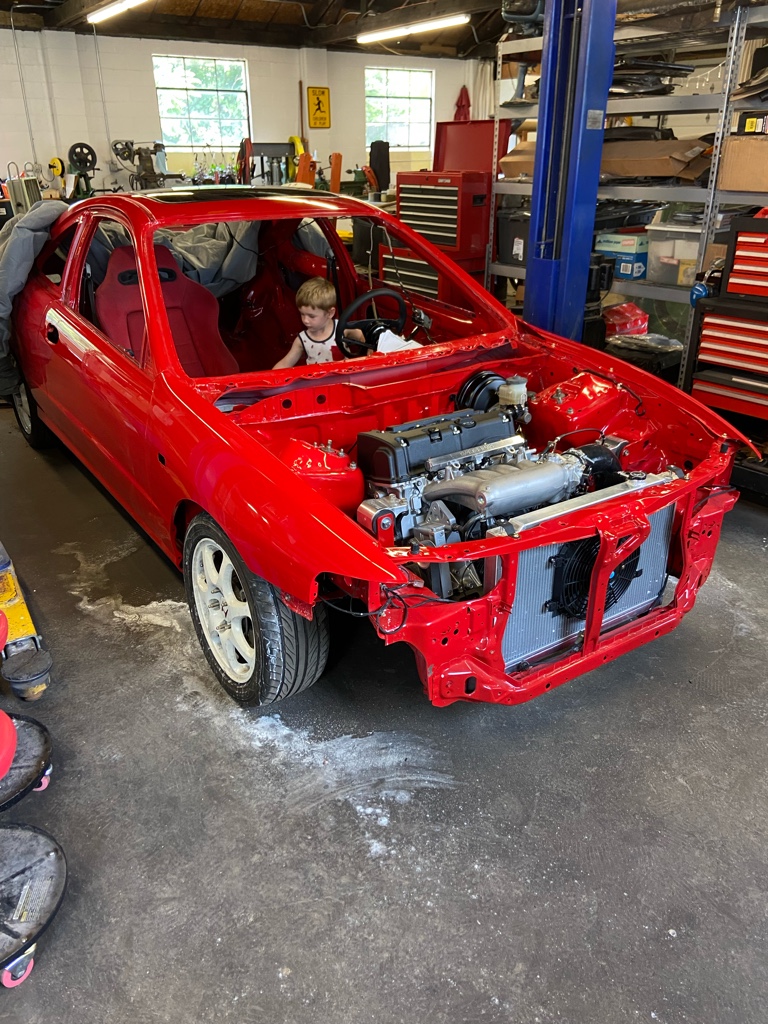

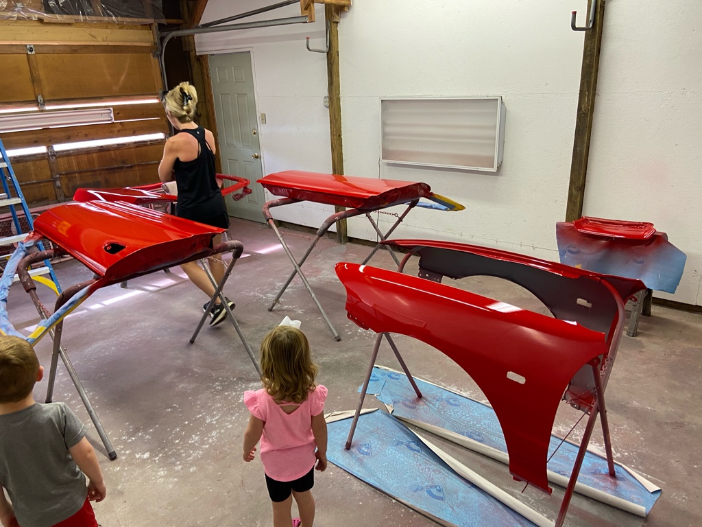

Probably my favorite part of this whole build now. I decided to bring my son with me the night we sprayed these, and had him shoot some primer on the fenders. Hopefully this car will go to him some day!

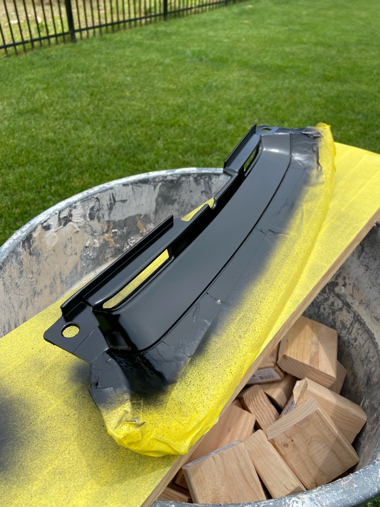

Ended up prepping the front grill and spraying it with those panels as well. It was silver previously, and you could see a faint silver line in the corner of the black plastic after the tape was removed. You'll see my solution for this a little later on.

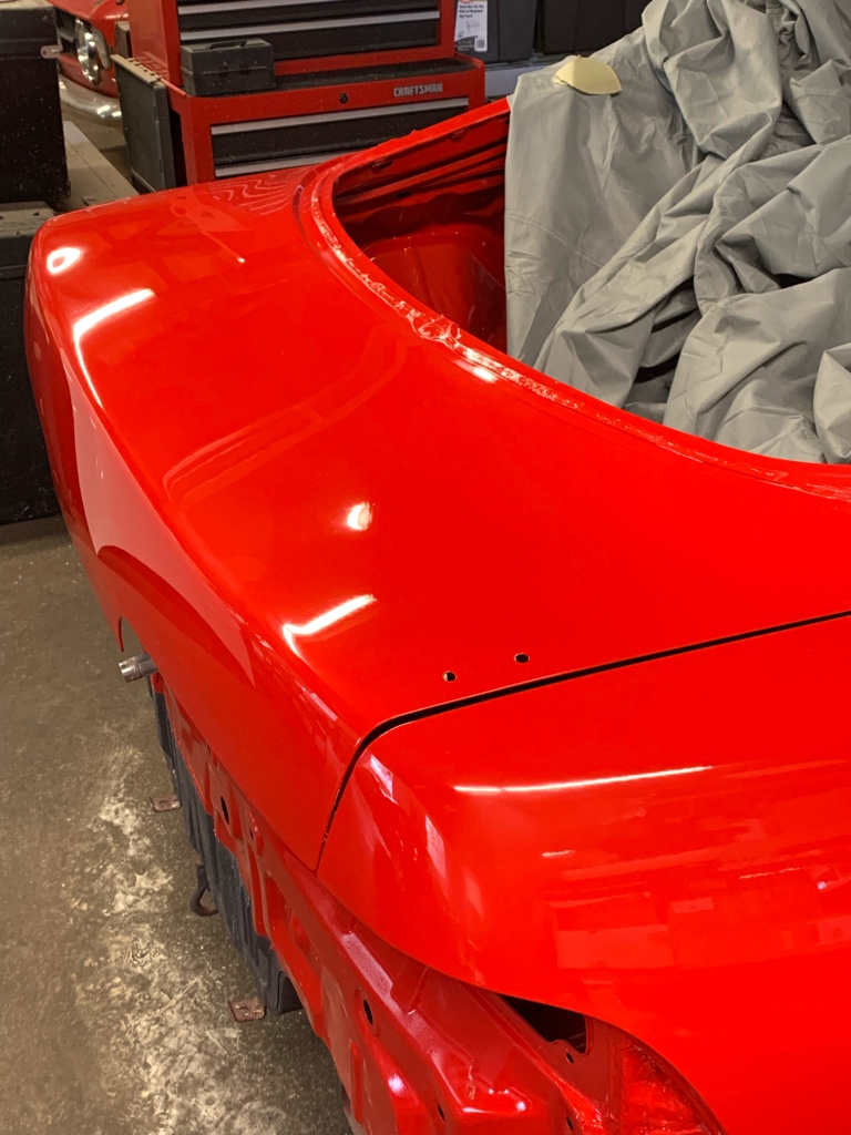

Rear hatch after some wet sanding and polishing.
Door after wet sand and quick polish.
Everything un-masked and pretty much finished.

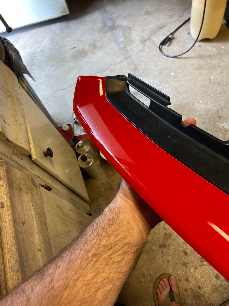

I ended up getting a can of plastic auto trim paint and re-painted the black trim. Turned out really nice and saved me from re-spraying the grill to fix that silver line!

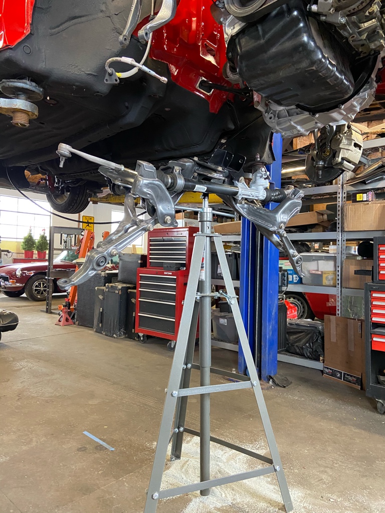

Back to getting this thing running! Subframe going up for (I think) the final time.
Final product of the brake lines and fuel lines under the car.

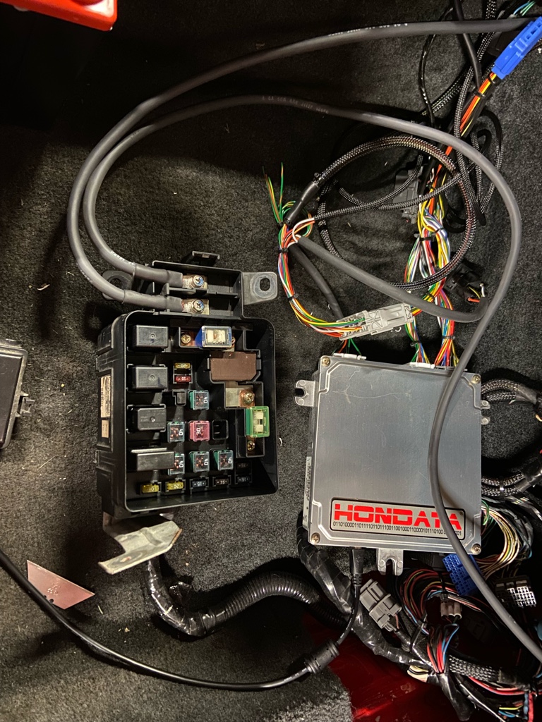

Underdash wiring going on here. What a mess. Really wish I could go with some kind of pdm solution that would clean this up, but I want to maintain too many features to use a pdm system (without getting insanely expensive).

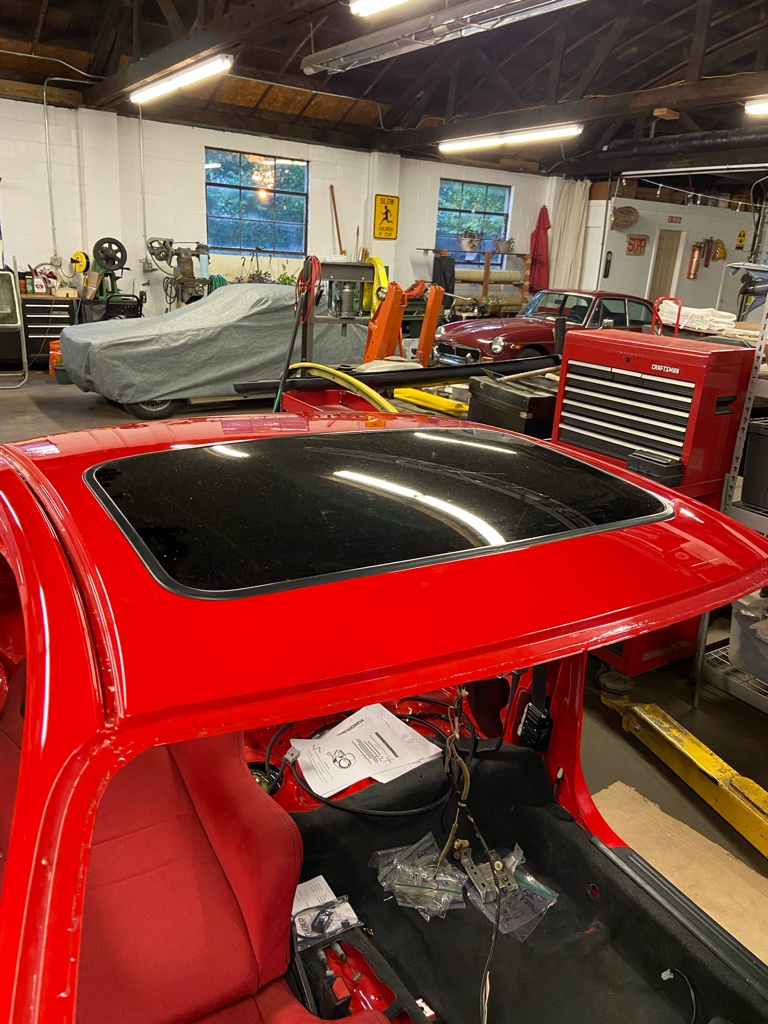

And finally got around to installing the sunroof assembly with the help of a friend.

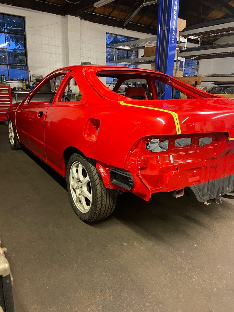

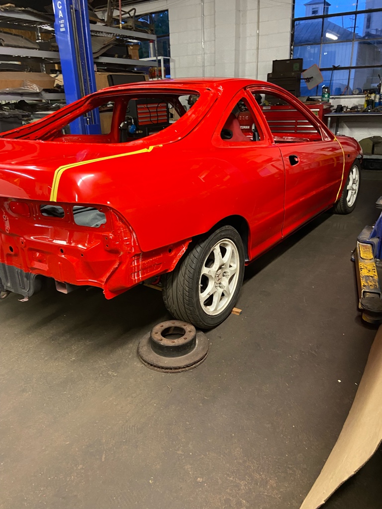

Transporting all the finished panels from the paint booth garage to the shop where the car is stored/worked on.

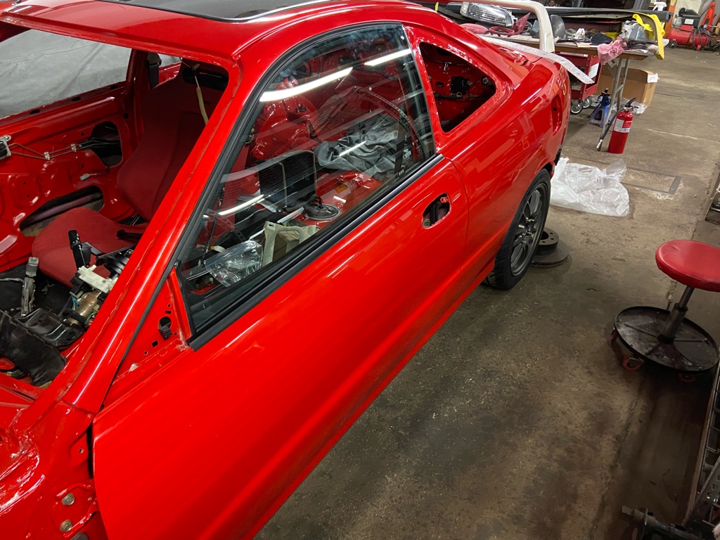

Got all the panels put on and lined up fairly well. After installing glass in the doors and everything else, they settled some, so they need tweaked still yet.

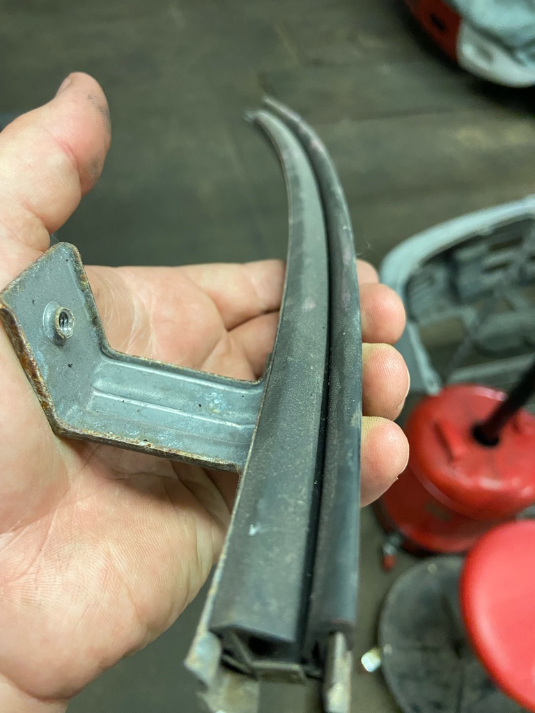

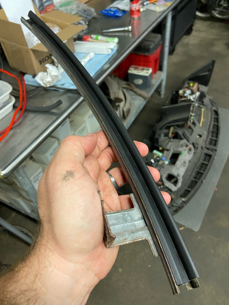

After getting the underdash put back together, started on the doors and window assemblies. You cannot buy new window track assemblies so I had to freshen these up.
Bought OEM honda shin etsu grease. That stuff is amazing!
Final result after very little effort.

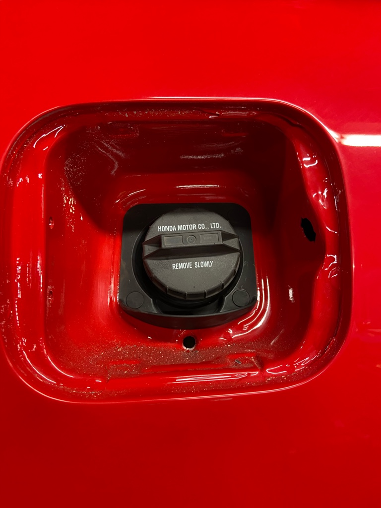

New Fuel neck gasket (accidently threw the old one away with the old filler neck).

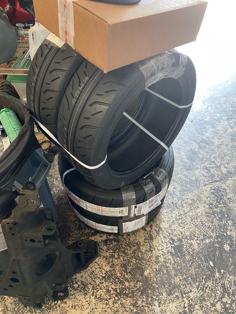

And finally bought some tires on clearance for the volks that have been sitting for years.

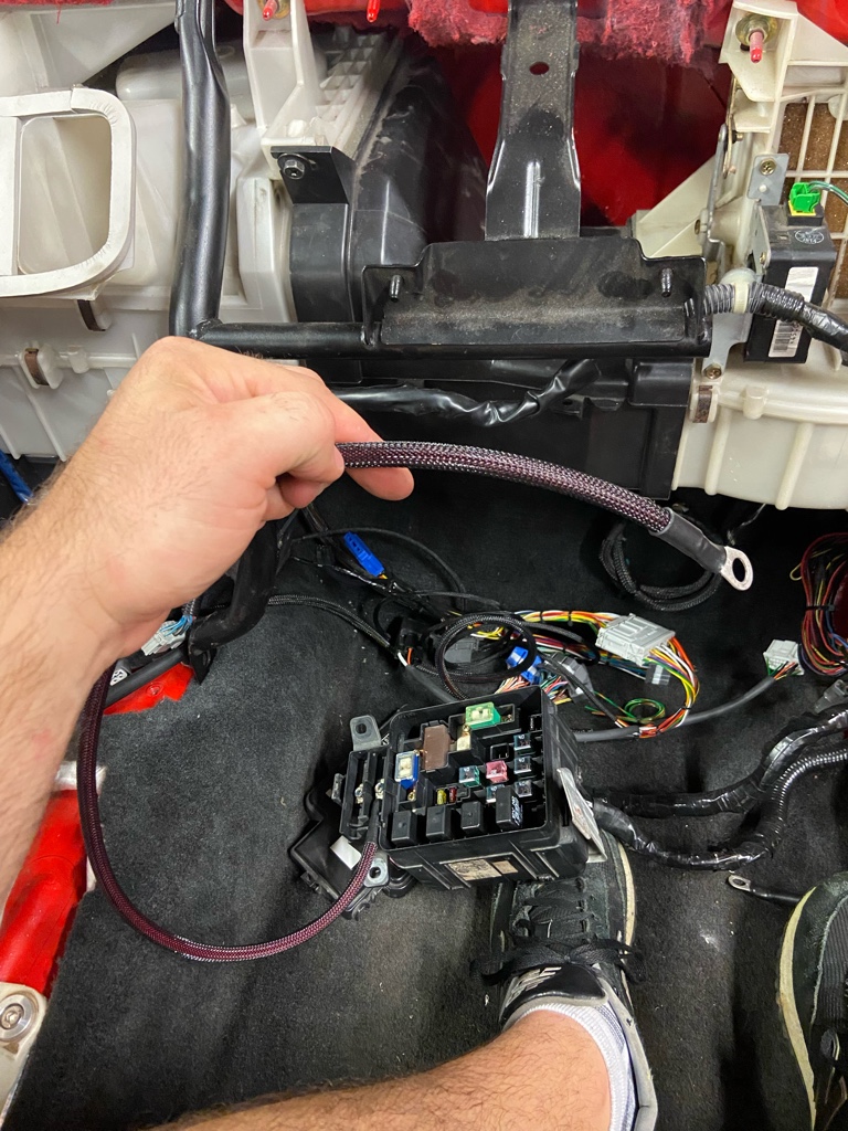

Ordered ground lines for the car, but they ended up being too short for where I had everything located. Ended up buying 13ft. of battery cable and some clamp on ring connectors and made new myself. Wish I would have realized how easy/cheap this option was to begin with.

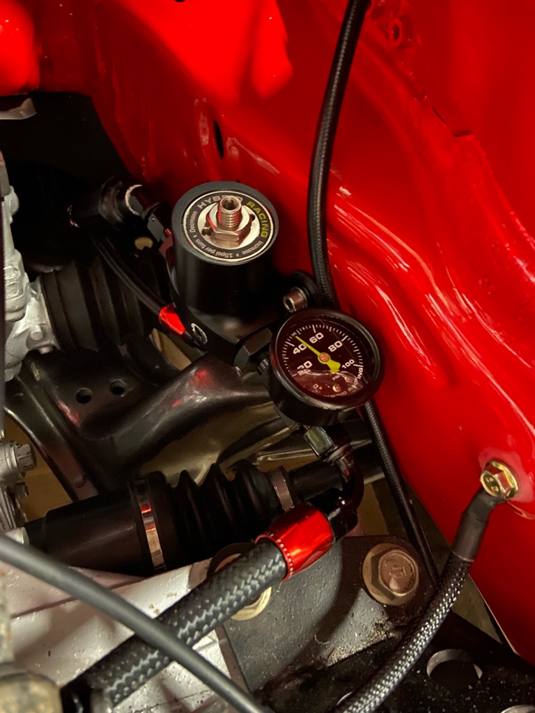

We have fuel pressure!

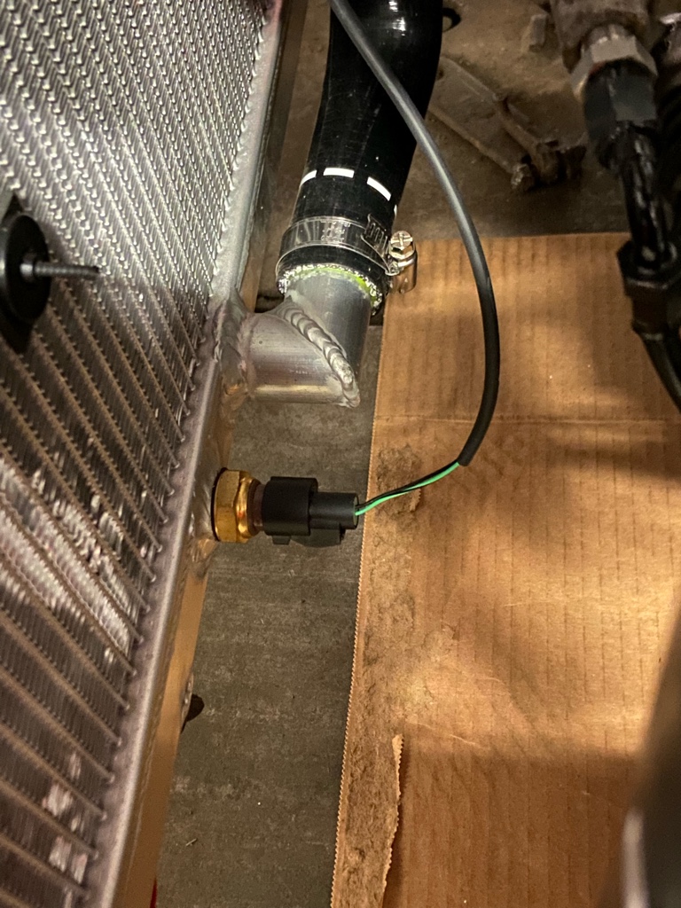

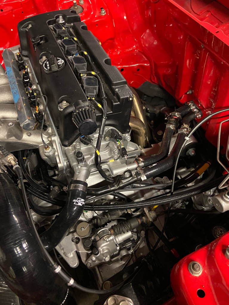

Fan switch in and connected. Had some trouble with the k tuned sensors that had some extra burs on the plastic. They wouldn't snap into the connector. After figuring out the issue a file solved it pretty quick.
Everything all finished up and the header starting to get some color after startup/heat cycles. I did end up having issues with my wireworx headlight tuck in a box kit. No matter what I tried I couldn't get power to the fan. After not being a huge fan of how they tell you to spool up the passenger stock headlight and tuck it under the dash, I tore out the wireworx harness and got all my stock stuff routed. Fan finally got power after that and no more extra wires spooled up under the dash.

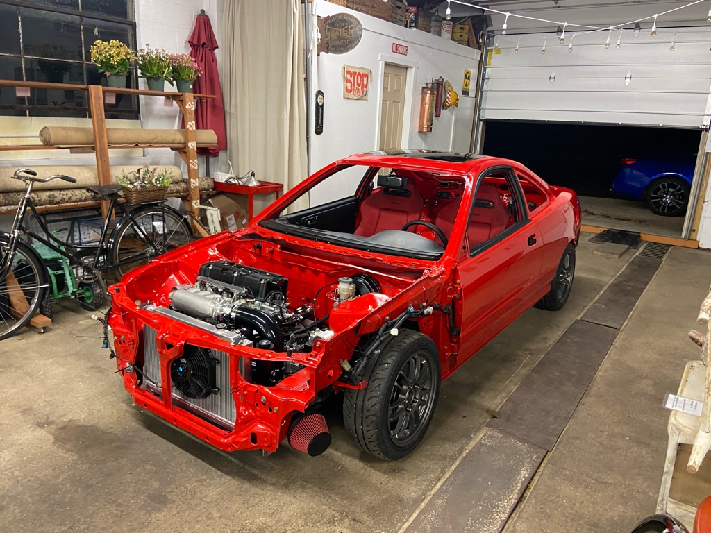

Maiden voyage down the street. The s2k clutch master adjustment was totally out the wrong was so it jerked around like crazy the first drive. Quick adjustment and that was fixed.
Interior all cleaned up!
Bay all cleaned up!
