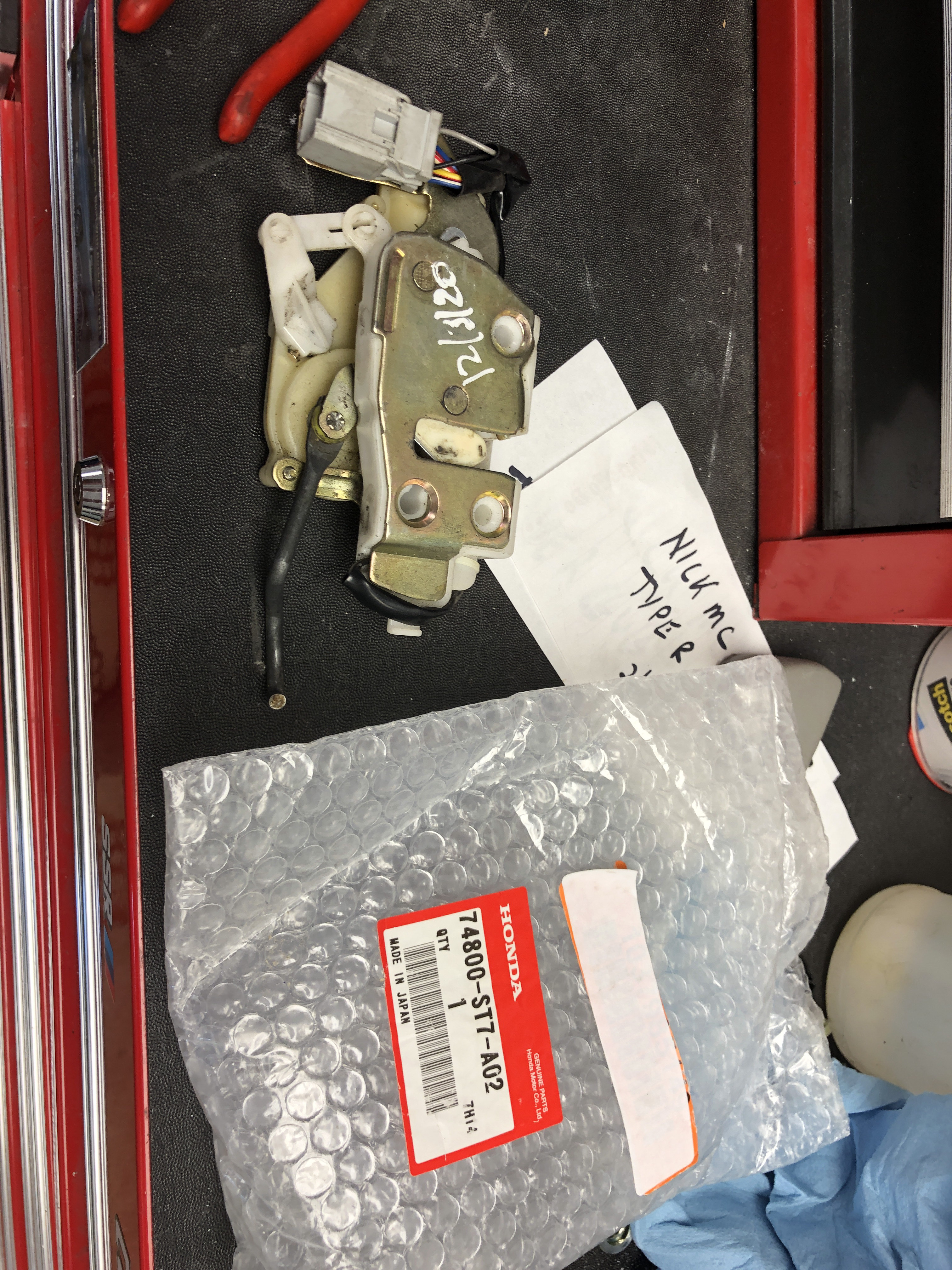

Finally got this delivered after a few weeks. It was back ordered with no ETA. Rear trunk latch. This was the old one. Had an issue with the servo motor not moving the lock switch. Tried lubing it cleaning it , went through 2 junk yard parts before I gave in and bought new OEM.

If i'm not mistaken I believe there is a part from an odyssey door actuator that you can swap the motor and other internals out of to fix the latch

mugen power wrote: Fri Mar 12, 2021 5:31 pm If i'm not mistaken I believe there is a part from an odyssey door actuator that you can swap the motor and other internals out of to fix the latch
hrmmm... I remember seeing a 3d printed fix for it.
https://www.thingiverse.com/thing:15386
I printed it but haven't had a chance to try....

Oh yeah I recall a member here made the 3d printed fix. Oddly enough with my trunk that piece wasn't broken and years later I am still have weird issues opening my trunk without the key even with a new actuator.
